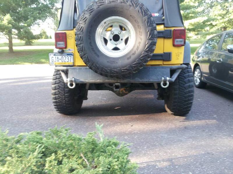

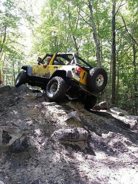

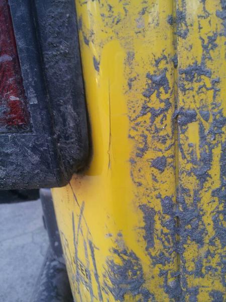

Ok! Back on track. I got the bumper finished before Topless For Tatas. I tested it by backing full speed into a tree that no one saw and banging it on various rocks. Held up like a champ. No dents or anything. I did break a tail light on the tree, but the bumper saved me from major damage.Click image for larger version

You got great talent my friend. I wish I had the skills and equipment to do stuff like that. On a judging point of view, I think I would have used bigger diameter tubing, with the plate welded on the inside, thus hiding the welds. And then get it all sprayed in LINEX material. But the design is perfect.

Thanks man, I appreciate the feedback. The problem with a larger diameter tube for me is that it's more likely to dent. I used rustoleum truck bed coating because it's really easy to touch up and holds up very well. Just gotta be patient and let it cure. I agree the welds look kinda crappy on the plate, but I was pressed for time. I'm going to go back over it in the next couple weeks and clean it up and probably fully weld the seam and grind it smooth. I'll post more pics when I get to work on it again.
