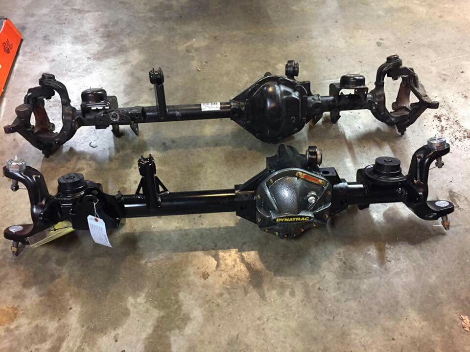

Here is a comparison between the factory Rubi 44 and the ProRock 44. There really is no comparison. 3" tube vs 2.5" tube, .5" wall thickness. All the bracketry and mounts, as well as the axle "C's" are massive. Anyone who thinks welding a truss and gussets on the factory housing will compare with the ProRock in strength is fooling themselves.
For those with Rubicons running a 37" or smaller tire, the ProRock 44 is a great upgrade that won't cost you $5k. You could swap all the factory internals and locker into the $2200 housing and be done, but obviously is a good time to upgrade the knuckles, axleshafts, and brakes.
There is definitely a comparison!
The comparison is value vs need. Your scenario has the Rubicon guy swapping housings out of pocket maybe $1700 ($2200 PR cost - $500 selling old housing = $1700 out of pocket).
The Artec armor kit (Truss, Gussets, Control Arm Skids, Trackbar Bracket) sells for $300. Add a heavy duty diff cover like riddler for $100. So $400 total parts to "uparmor" a Rubi 44. This guy has an extra $1300 in his pocket which can buy some RCV shafts and a lot of gas and beer. I would take a armored and RCV shaft Rubi axle over a PR with stock shafts any day and twice on Sunday.
If the same can't weld he's out of pocket maybe $800-$1k less than buying a PR housing, depending on where he is located and what welding costs. That's still a nice chunk of change.
The trussed housing isn't as strong as a PR but do all buyers need it need to be? Do they need the added castor? Maybe, but maybe not. Obviously you pay more for the PR but do you need that and what's your time and $$ worth to you. There is not a clear cut answer I think. I have no regrets about adding a truss and armor to my Rubi housing and getting RCV shafts with the savings. This set up has not had any issues for me wheeling all over the southeast.
