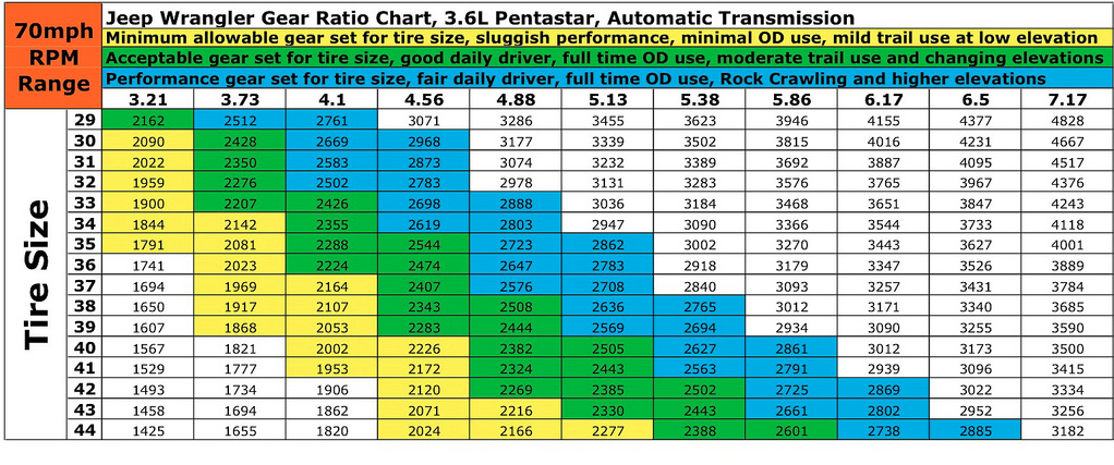

Would you consider a trade for a PR44U (35 spline ARB RCV, Dyna ball joints) and SF PR60 in 4.88's practically brand spankin' new? The PR60 will be ordered here in the next 2 days so I can still change the rear diff to ARB, EATON, etc. They are stock JK width.
I could probably make do with the 3 link up front but I'd definitely need to get the rear CA mounts back to stock and have rear spring perches welded in. I've got the EVO King's LCG front kit sitting here waiting. Was originally planning to keep the rear AEV coil/strut for the time being. I'm planning 3"-3.5" lift.
The main issue is the 5.13's. Not sure how I feel being in the 2700 RPM range on 36/37's since it's a daily driver so that's why I haven't pulled the trigger on yours....
