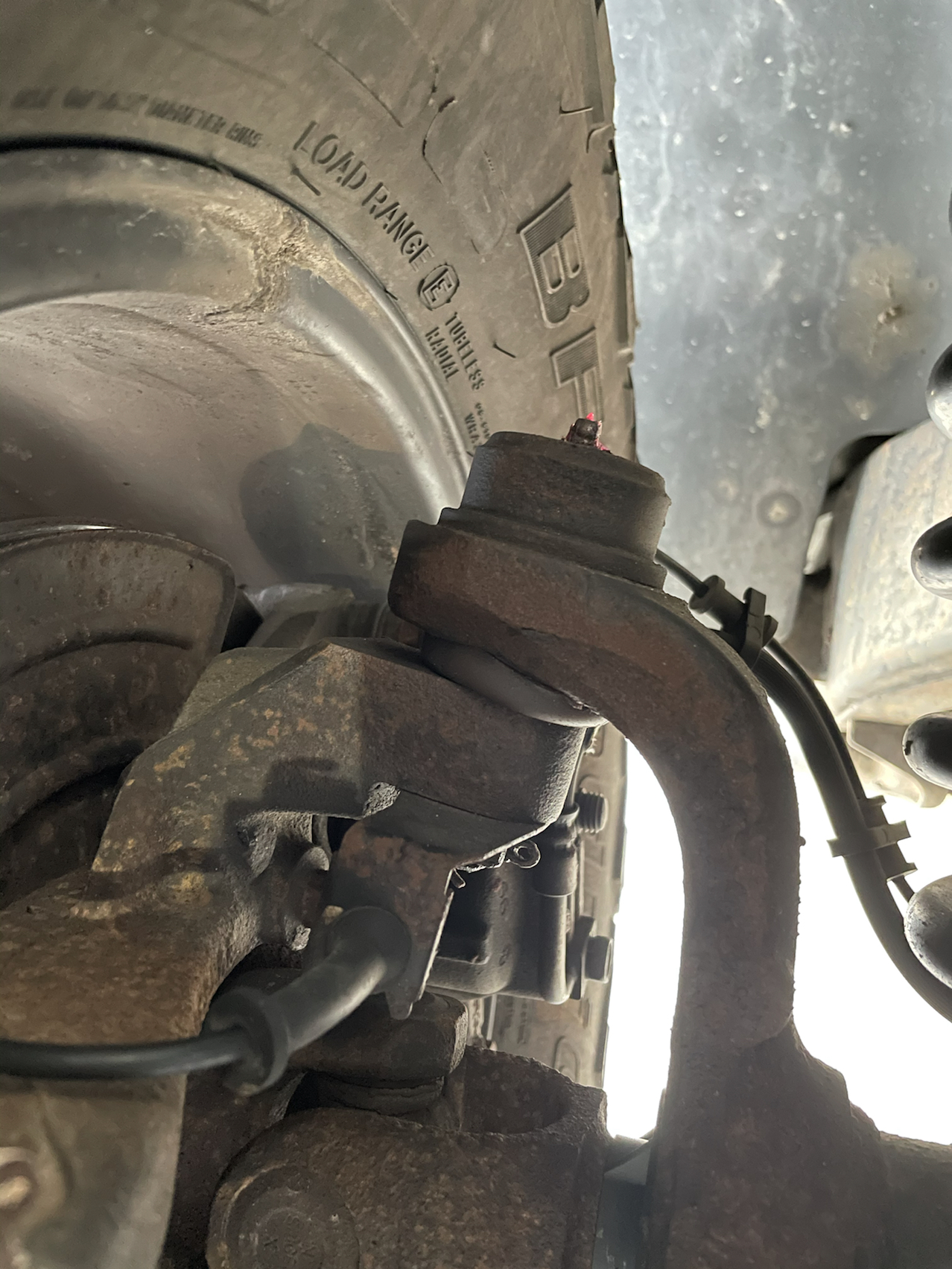

Can a visual inspection point out a worn ball joint like the pic I have above? I will jack the front end and do the pry bar check and wiggle check of the tires, but I feel that I've been staring at those for 10 years now, and they didn't look that squished. Especially since they have fresh grease Mobile 1 synthetic before my trip and then again in that picture. 2 pump chump.

I don't see a BJ pick above. IMO, you're not gonna diagnose via a visual inspection with everything assembled. It's gonna take a pry bar or shovel under the tire creating direct upward pressure and then look for movement between the gap where the knuckle and C meet....at the upper BJ is usually the easiest to spot for me. Any "flex" is ok, but you shouldn't see that moving up and down at all. Again, I don't see a picture so hard to tell what you're seeing, but I'd say most people probably overfill with grease and use the boot as a reservoir of grease....and the more you pump in there the more it's gonna bulge or appear "squished".
I've not looked at Synergy BJs in quite some time. If you've had those for 10 years I'd say they are not lifetime warranty. I had several sets of Synergies back in '14-'15 and recall them being 1-year warranty it seems. That said, I think you might just be being a little worried about nothing. Usually a bad BJ doesn't conceal itself very well when driving. I think if you had a bad one you'd be feeling it here and there.

Sorry it didn't upload with the other pics. The front end seems a little rough with brand new shocks. I'll tighten the control arms tomorrow also.

Ok so I re-torqued all my control arms and checked the ball joints. There is no play in the ball joints and the drivers side front lower bolt on the control arm was either seized on or way too tight. As soon as I loosened them all up and re-torqued it's driving like a dream again. It seriously felt like my tires were out of balance because of the control arms.
