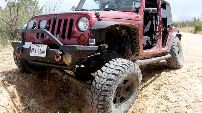

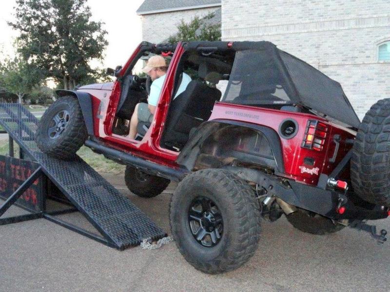

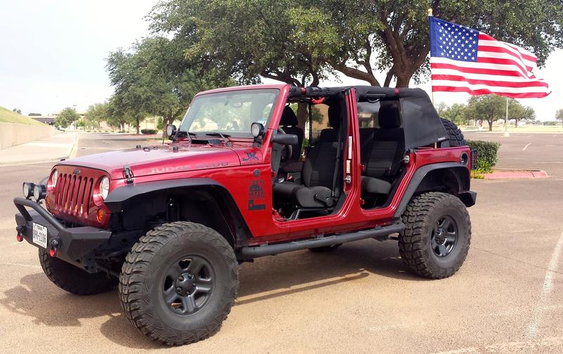

so please clear this up for me
heres what im running right now:
jku
2.5" suspension lift
1.25" body lift
trimmed factory fenders
bilstein 5100 shocks for 2.5" lifts
2.5" lift sway bar end links
extended brake line brackets
factory bump stops
315/75r16 mud tires
1.5" wheel spacers behind factory steel wheels
should i change my bumpstops at all?
i wheel pretty hard and have never had any issues
i dont 100% understand the benefit of altering the bump stop length
guess ive heard too many contradicting opinions about them
With your build, as long as you aren't over-compressing your shocks, you're fine. If the shocks are bottoming out before the bumpstops hit, you might cause some damage if you come down hard.
The benefits of extended bumpstops would be: Not over-compressing the shocks. Not stuffing the tires up too far and ripping fenders off or slicing them on the rear pinch seam. Not banging the flipped drag link/trackbar bracket up into the frame. Stuff like that.
But the way I read it, between the coil lift, body lift and chopped flares, you have all kinds of wheel well clearance, so bottoming the shocks is the only thing I can think of that you might want to check.
i damaged my factory shocks so i replaced them with the bilsteins
im assuming the damage was due to bottoming them out
at full flex my tires dont rub anywhere
if i go to 37 ever i guess ill worry about bumpstops (and a bunch of other stuff like gears, axle sleeves, pinch seams, wheel bearings etc) at that time
thanks for the helpful advice nthinuf!
jku
1.25" body lift
factory bump stops
315/75r16 mud tires
Attachment 481874Attachment 481875Attachment 481877
Off topic but man I love the way those factory steelies look painted up with real tires on them. Nice Jeep
thanks rob
im really happy with them
im also really happy with how cheap they are to replace ($35) and how hard they are to damage (compared to an alloy wheel)
while there are some prettier alloy wheels if i had it to do over again id paint my 16" steelies again
