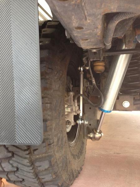

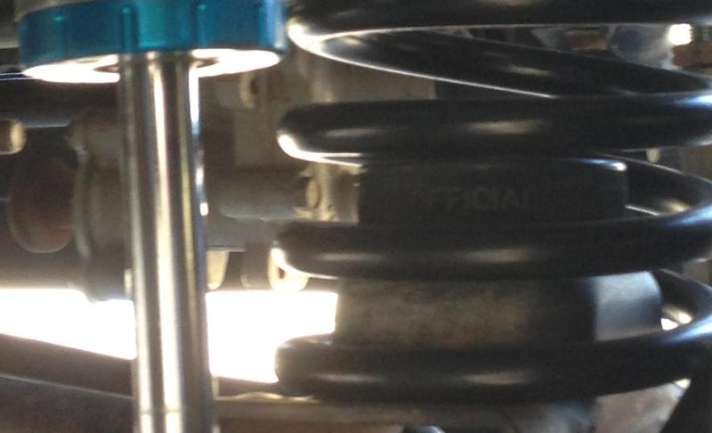

2" is a lot of bump stop, is this because of over compression of the springs.
I have a 2" lift with the hockey puck for the front and a piece of 5/8 aluminum
block for the back. I do have a body lift maybe why it seems like a lot to me.
Front had to drill and tap a 5/16 thrd.
Back just drill out 2 1/4" holes with flat head
screws 3/4" long with nuts, painted black
