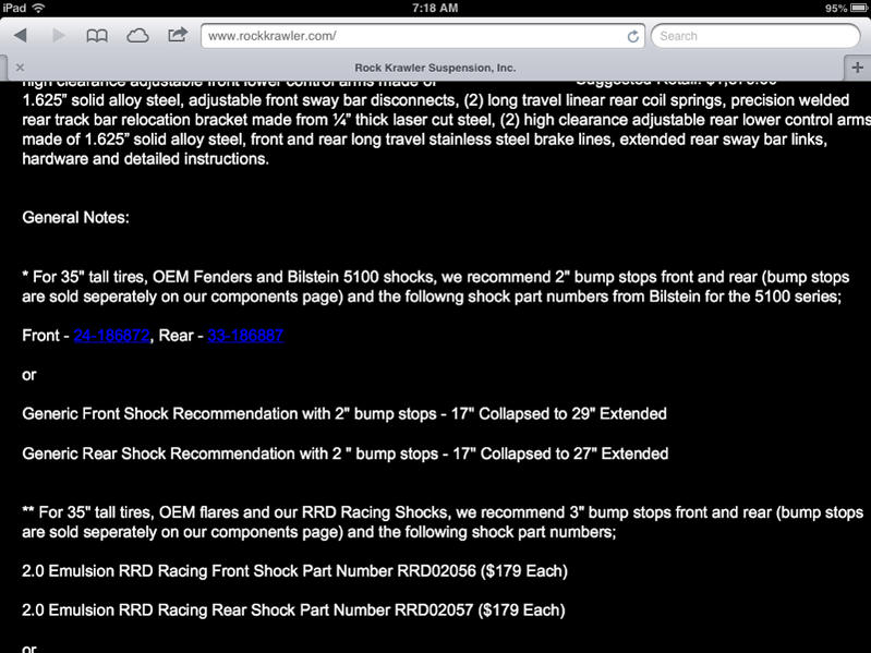

This is the setup I'm doing. This is directly from rk website. Stock flares, bilstein 5100's, and 35" Goodyear duratracs.

I ended up putting in 2" bumpstops per rock krawler when running 35's and oem fenders.
