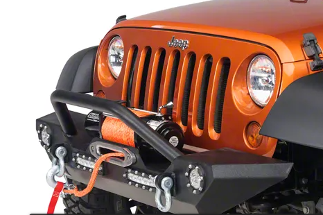

Bumpers are one of the few areas that people can kinda "cheap out" if that is what they want. Can't say that about many other things in relation to a jeep build. I'm not going to criticize subjective looks that people may or many not want, but I would say that ET is one of the worst retailers IMO, and you might want to rethink the idea of a bumper that is going to overlap your grill like this -
If you can find something that allows you to remove your grille without having to remove your bumper I'd suggest it. For different reasons, I have to remove my front bumper and winch in order to get the grille off and I can tell you first hand that just sucks.

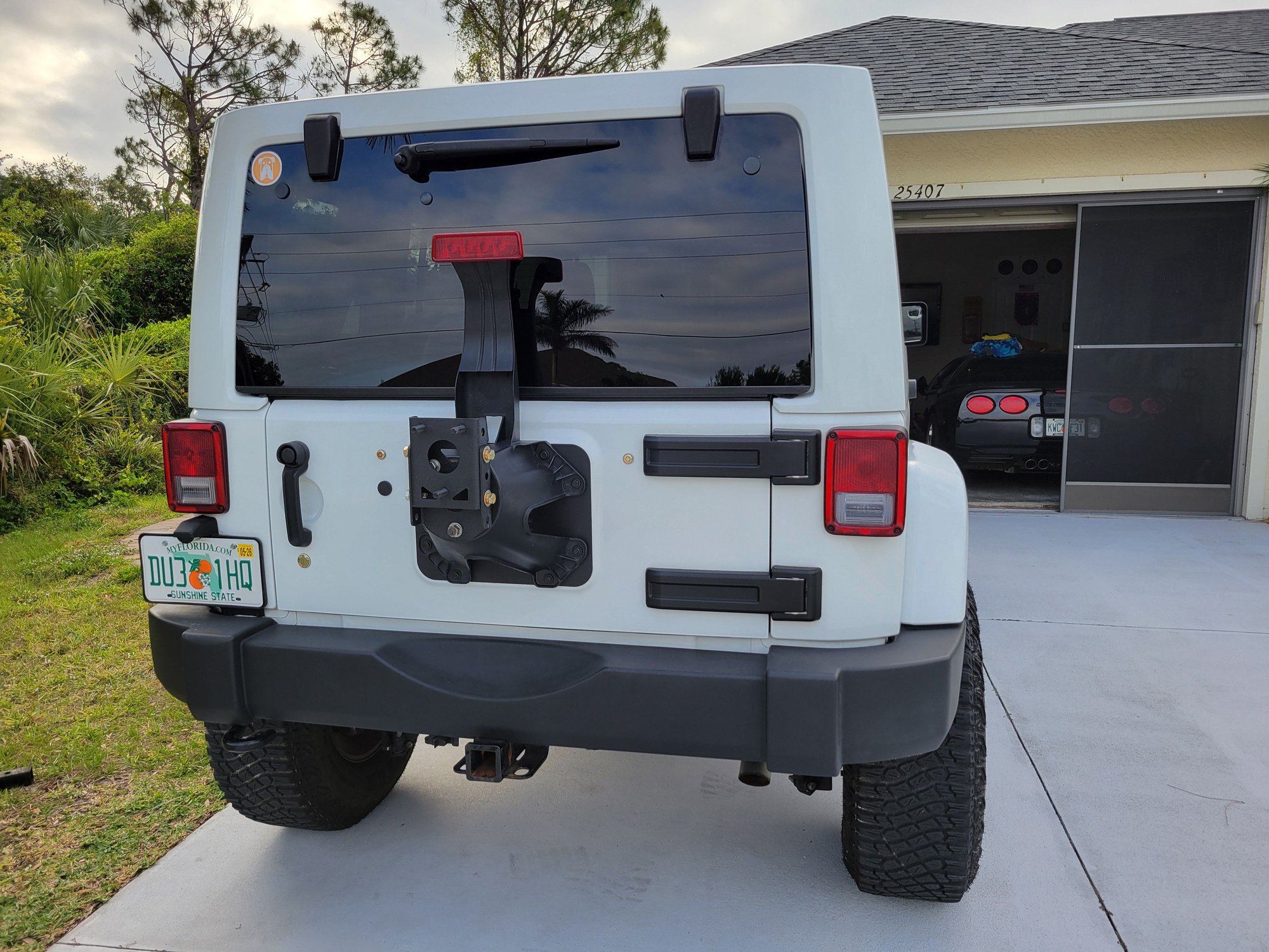

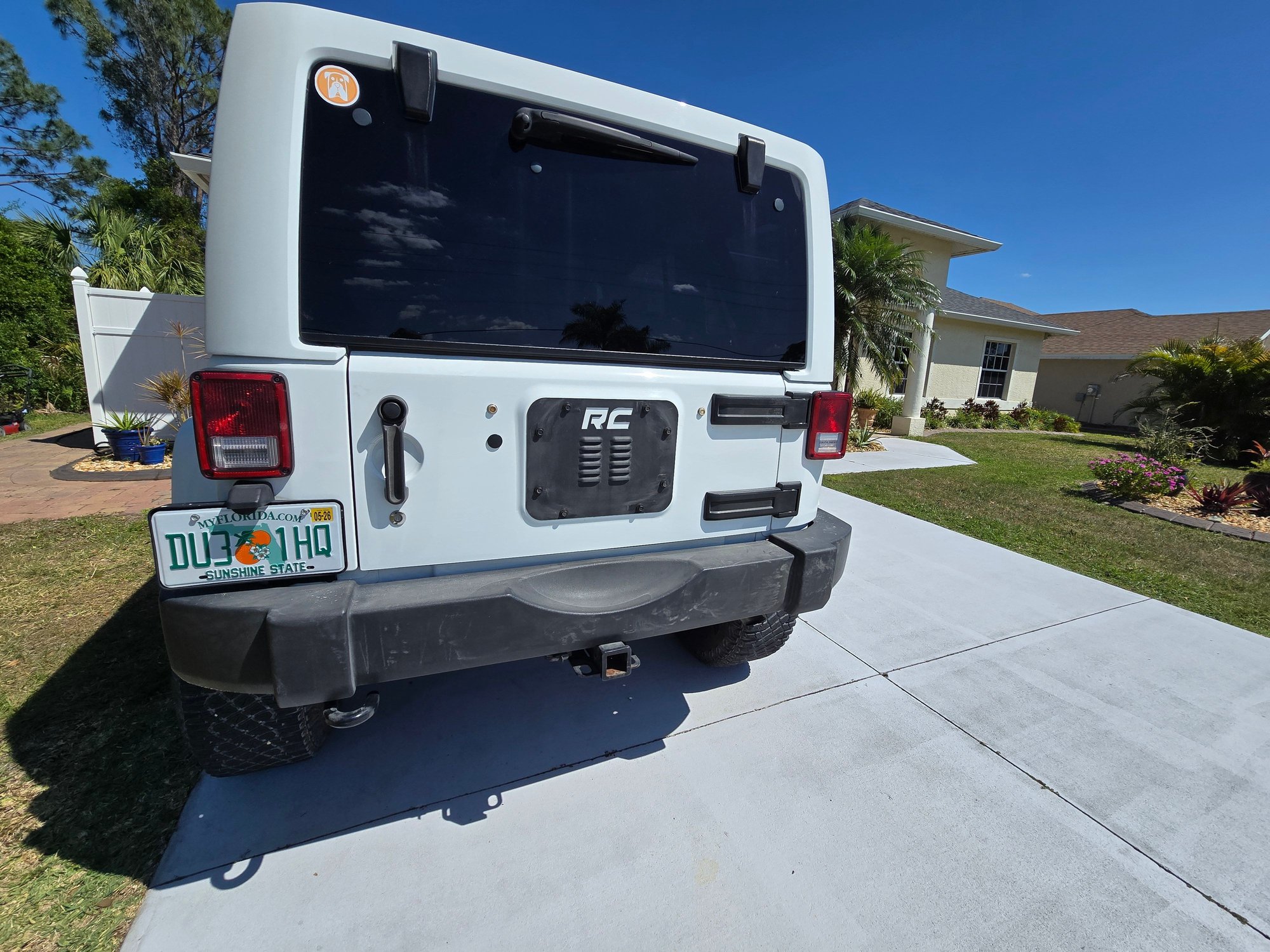

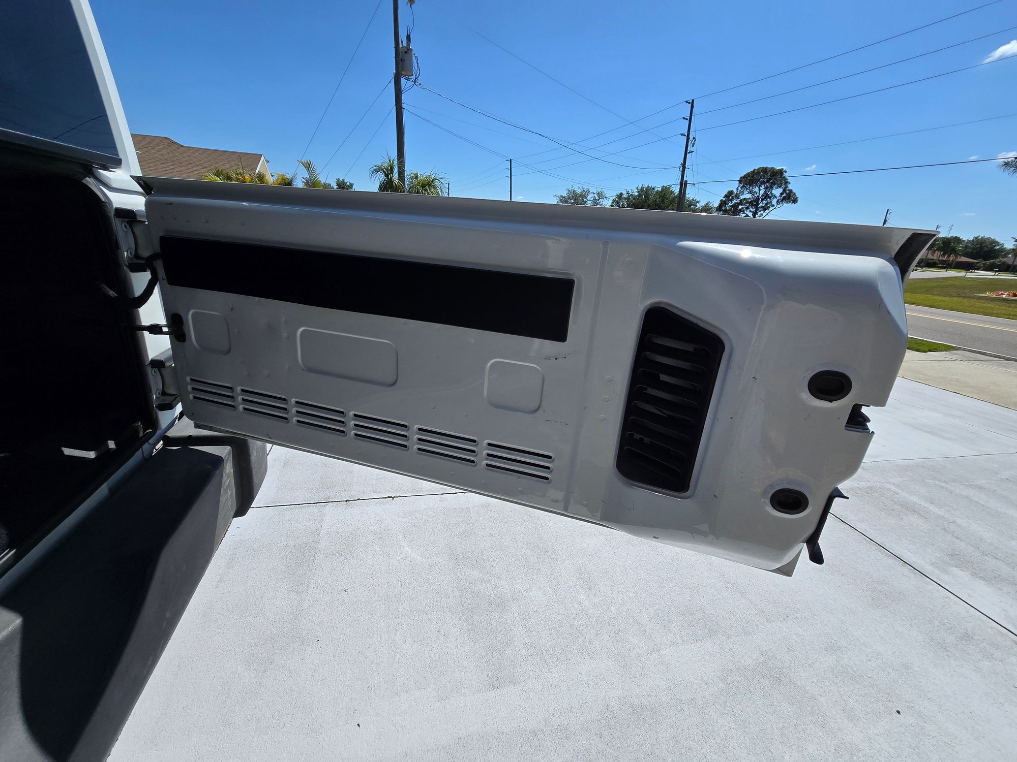

Concerning "One concern is the tire carrier and how it will hold up on trails hitting holes and going over obstacles", as I mentioned in your other thread, you have aftermarket tire carrier reinforcement. Did you identify what reinforcement is in the inside of the tailgate?
It's up to you if you want to move to a bumper-mounted tire carrier. I have one myself. But generally tailgate reinforcement is plenty good for 35's. So spending the extra money is up to you.

Im not sure I know what reinforcement you are talking about.
Old Apr 14, 2025 | 01:45 PM
AZJeeper's Avatar
Super Moderator
Community Favorite
Joined: Sep 2007
Posts: 1,750
Likes: 89
From: Arizona
OK. That makes it clear. I'm on the same page now. The previous owner put on the Rough Country tire carrier "reinforcement" kit and deleted the tire bumpers. Those bolt heads where the bumpers went are just decorative. There is no hinge reinforcement, and that is where the problems are when putting on 35+ and beating the bumps. Thanks for sharing.
