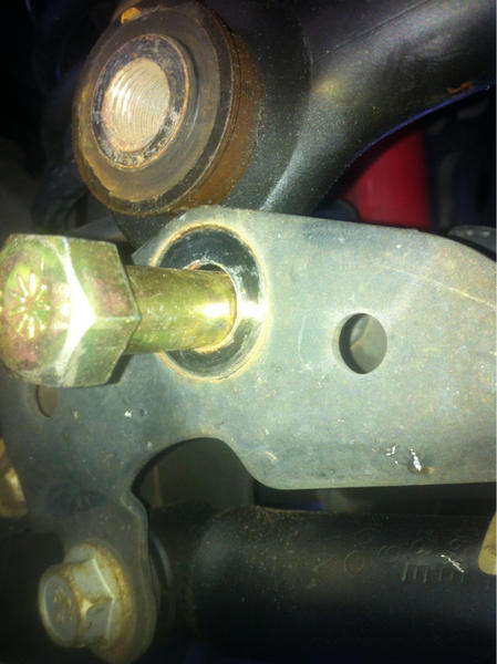

Track bar bolts are probably my problem
This shows the slop in the holes even with the new thicker 9/16 bolts.

looks like it may be time to weld some washers on there. easiest way to solve that.
or you can get a new bracket or reinforced bracket to go on there.
