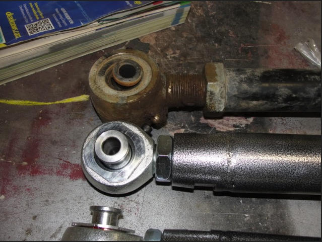

Most likely your axle shifted when you removed the stock control arms. Use the measurements provided then pull the axle into position with a ratchet strap or if the tires are still installed just roll one side by hand. They'll move pretty easily.
Don't forget to forget to Loc-tite the control arm jam nut, use a slugging wrench to help torque it. You can do it on the vehicle but I've found it easier to do in a workbench vice. You want the joint to be straight once installed (like the bottom one in the pic below).

Originally Posted by Tripletsi
Most likely your axle shifted when you removed the stock control arms. Use the measurements provided then pull the axle into position with a ratchet strap or if the tires are still installed just roll one side by hand. They'll move pretty easily. Don't forget to forget to Loc-tite the control arm jam nut, use a slugging wrench to help torque it. You can do it on the vehicle but I've found it easier to do in a workbench vice. You want the joint to be straight once installed (like the bottom one in the pic below). <img src="https://www.jk-forum.com/forums/attachment.php?attachmentid=587823"/>
