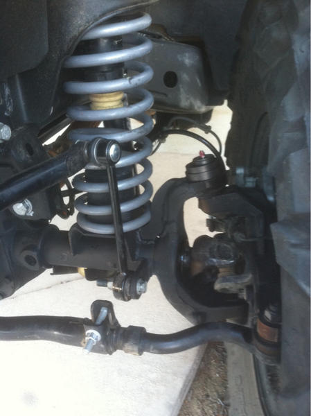

Old Jan 20, 2014 | 11:06 PM
redlinin616's Avatar
Joined: Jul 2013
Posts: 608
From: high desert, CA
I've got 35s. and after I installed a 3.5" lift and teraflex flex arms.. then synergy ball joints have my rig riding perfectly straight and all within specs.. the extra adjustment is well worth it. I also sleeve and gussetted the front

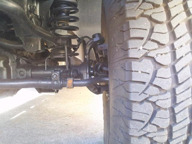

Old Jan 20, 2014 | 11:08 PM
Joined: Jul 2013
Posts: 608
