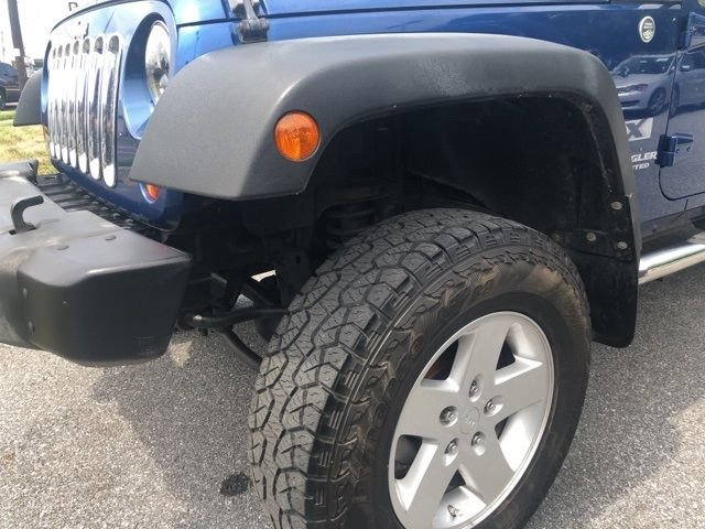

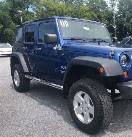

Thanks! I'm attaching pics of the one I'm driving tomorrow...does this little peek tell anything? I'm so in love with this color blue, the chrome accents...and it is manual, woo hoo! (harder and harder to find) Also loaded with the power options, so checks LOTS of my boxes...just not the lift. And maybe it's wishful thinking but this just doesn't look "that" high to me? Like from pics looks like the footsteps are kinda at a normal height. Maybe I'm fooling myself and when I stand next to it I'll be like yeah...no, not happening. ha haa.

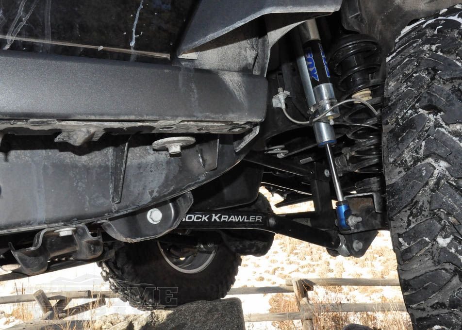

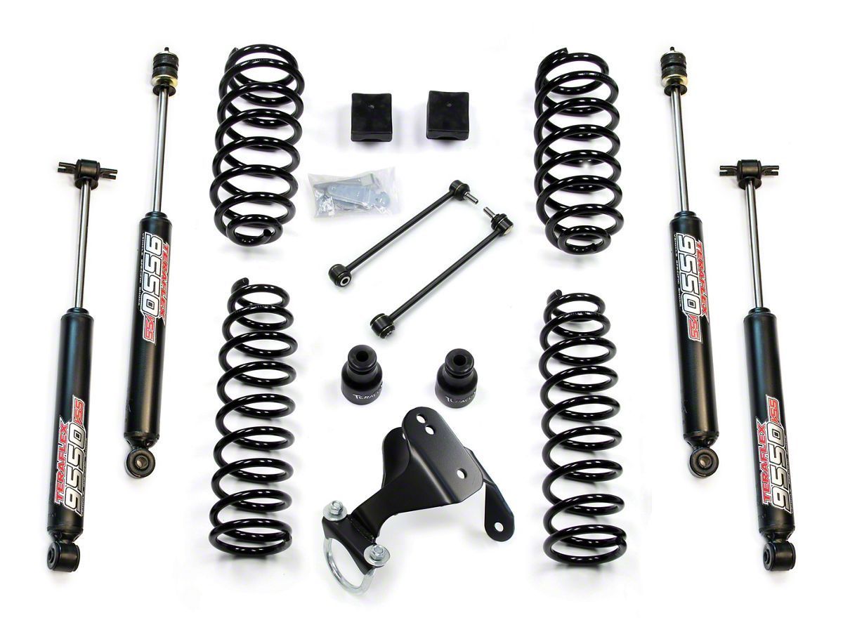

Those pictures don’t show us enough, but just my blind impression is that is not an overly modified Jeep- it probably has a bolt on lift kit. You can probably find out the exact kit from the salesperson as it’s a selling point for them.
I’ve posted an example lift kit below- the shocks, springs, swaybar links, bump stops, brake line and track bar relocation brackets- those are the things your looking for that you would be removing
i also posted a picture of adjustable control arms; you could have aftermarket arm / track bar kits- as long as they’re adjustable (Have threaded ends or middle sections, they don’t need to be replaced, they can just be shortened. At a minimum, you’ll need stock front swaybar links, shocks, and coils- someone in town where I live is asking $200 for their takeoffs- that’s probably the cost of unlifting it partwise- you’ll likely need another pair of hands or a shop to do the work- getting springs out can be tough- so add some labor cost at $100 an hour if you want to go that route, probably a couple hour job. Just my two cents
Teraflex lift kit example
Aftermarket control arms (labeled with rock crawler)

Wow, great info! Thank you so much. This really helps me understand it all more. Hopefully the sales guy can provide the info I need. So far I have learned, it "can" be un-lifted...and I'll paying someone to do it. I was kinda worried it might be harmful to un-lift a Jeep once it has been lifted. So I'm glad it seems that wouldn't be the case. So now...am I gonna be able to get in it tomorrow??? lol To be determined...

If you decide you like that vehicle, take some pics and we can probably help you with what aftermarket components are installed. As you may have gathered, there are several different ways to lift, and a variety of specific components that may or may not have been used.
A shock, especially if it shows a company logo.
A front coil, including the top and bottom so we can see if there is a spacer and get an indication of bumpstop height.
Front control arms on one side, both upper and lower, including the bolt at the axle end of the lower arm and where both arms connect to the frame.
I doubt there is steering correction, but take one of both ends of the trackbar and the draglink so we can eliminate that.
Rear - both ends of the trackbar to see if there is a bracket.
You could even take a quick measurement and see what you come up with.
