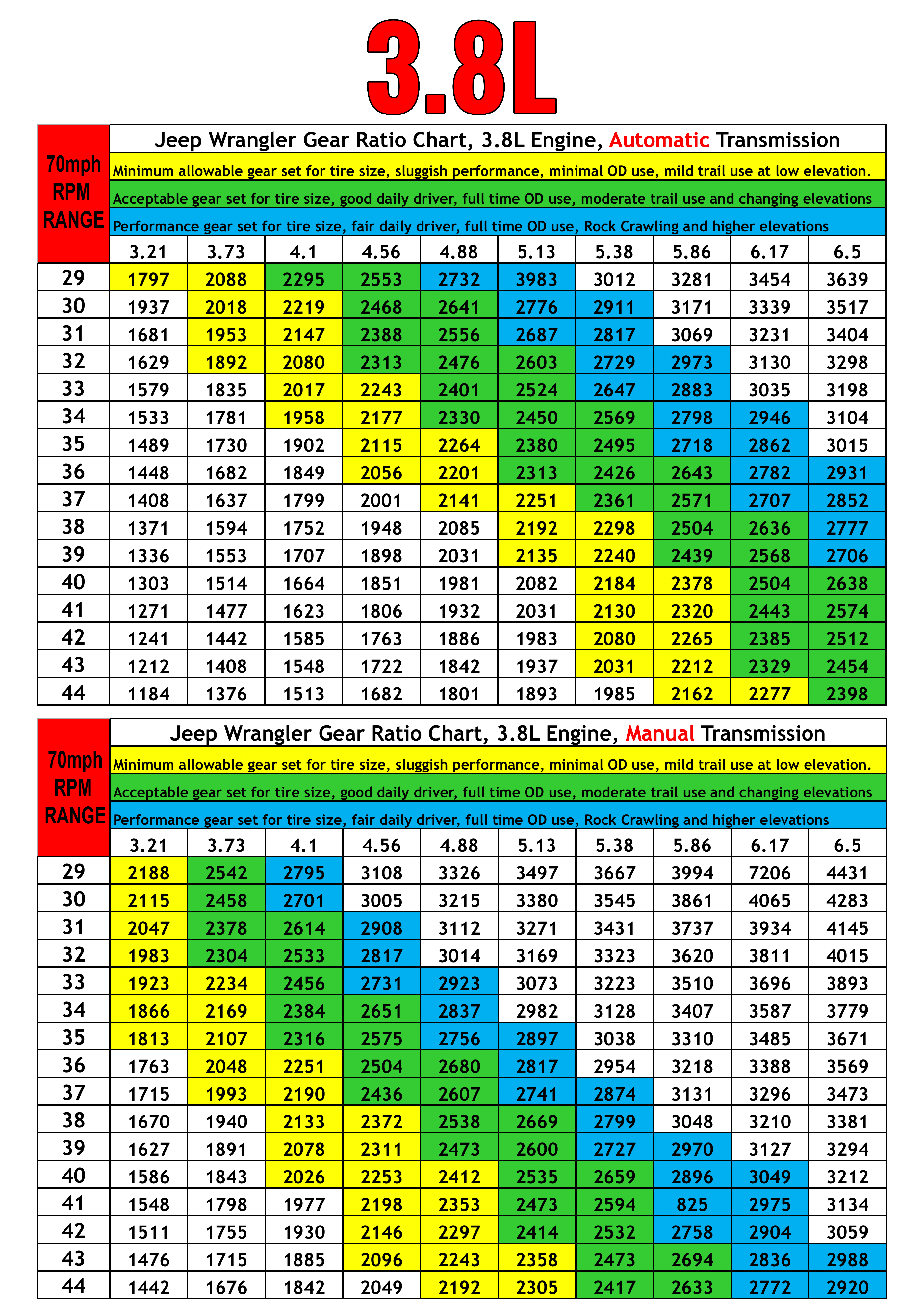

I feel at home in this thread as Karl, Kashakoo, and I all have or have had 2010s - seem to be a dying breed. To put it in non-technical speak, the lower gear ratio numbers (3.21 is the lowest they go for us), are are good for fuel economy on flatter roads, but they don't have as much power. The higher number gear ratios have more power, but they're not as good on fuel economy. Thats why karl said with 3.21s he had to use 3rd gear to get up a hill - he had to use one of the larger transmission gears to make up for the differential gear ratio. I've posted a popular gear chart for our JKs to help determine what gears are ideal for different tire sizes / situations.
FWIW, I still have 3.21 gears on my '10 JK with 33" duratracs and a 2.5" lift - 6th gear only gets used on flat highways, and I have had to use 4th to maintain speed going over the smokies, but i'm pretty happy with it and it hasn't been worth the $1600 parts + labor to re-gear. You dont have to re-gear, especially if you were happy with your old '10, but the JKU is bigger, maybe you'll feel differently now. You could always ask the dealer to knock off $1600 so you can get it re-geared but they'll probably tell you to kick rocks
P.S. Stock sports would have 3.21s in 2010 manuals unless you had the tow package, which i think came in 3.73. Autos came with 4.10s i believe
