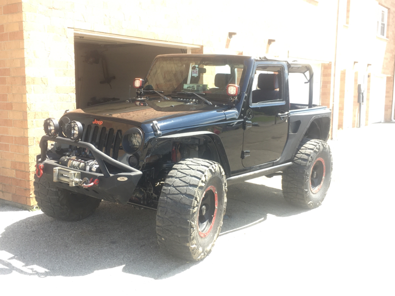

Old Dec 27, 2016 | 07:07 AM
Chuck-The-Ripper's Avatar
Joined: Oct 2015
Posts: 1,181

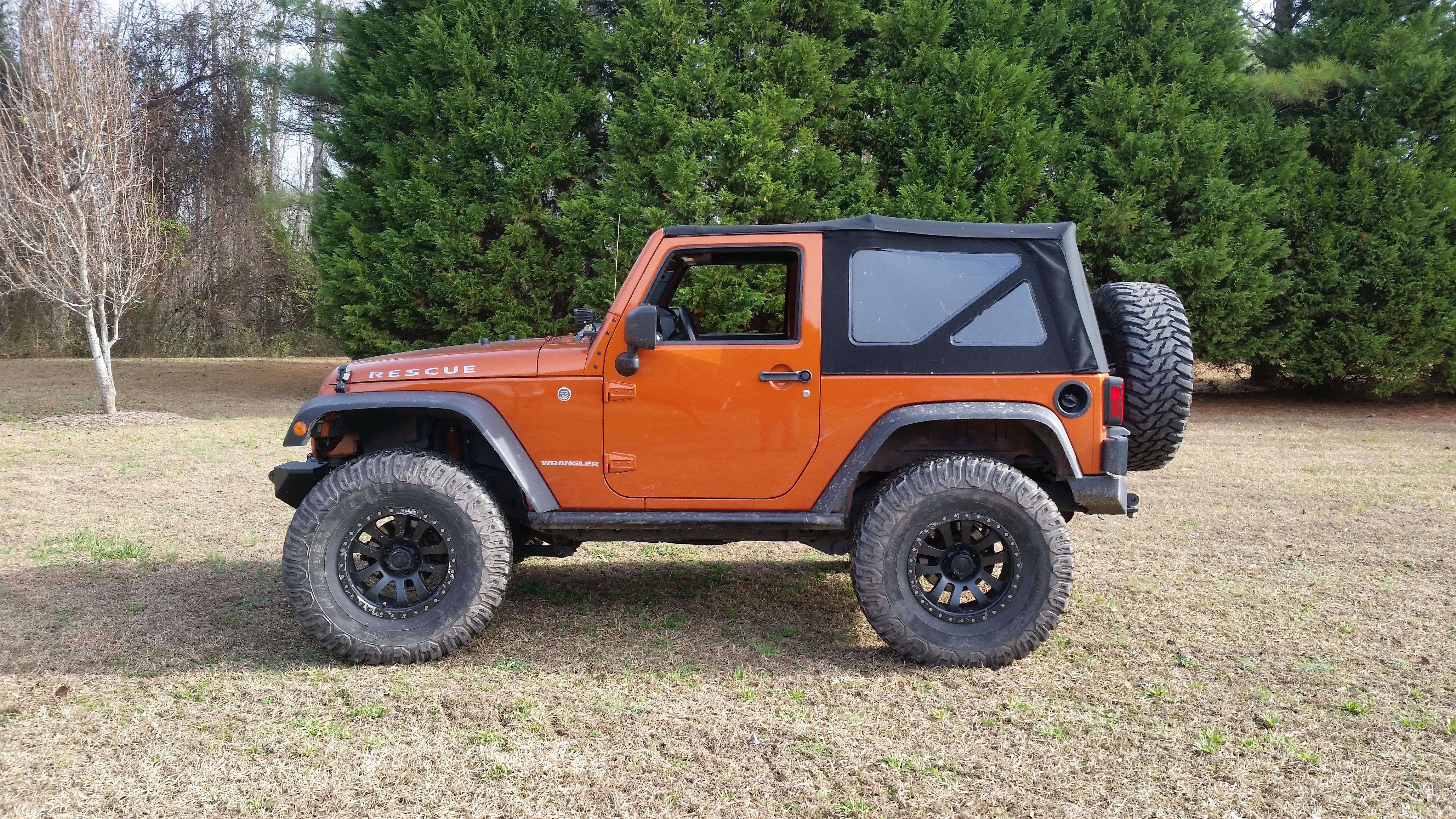

37s and a 2.5"
ID:	663519   Click image for larger version
ID:	663520   Click image for larger version
ID:	663521   Click image for larger version
