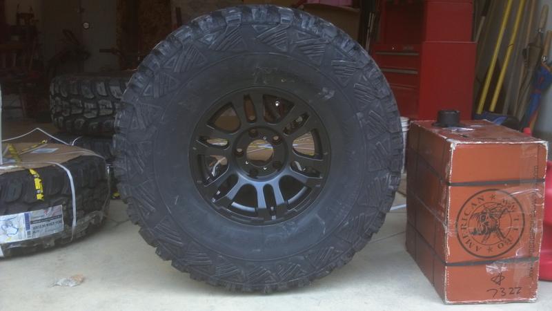

15's will totally fit - although some may require some minor grinding of the calipers. Here are the 15's I recently got... MB TKO with MB Chaos center caps... I love the look of small wheels and lots of rubber on a Jeep - classic!
