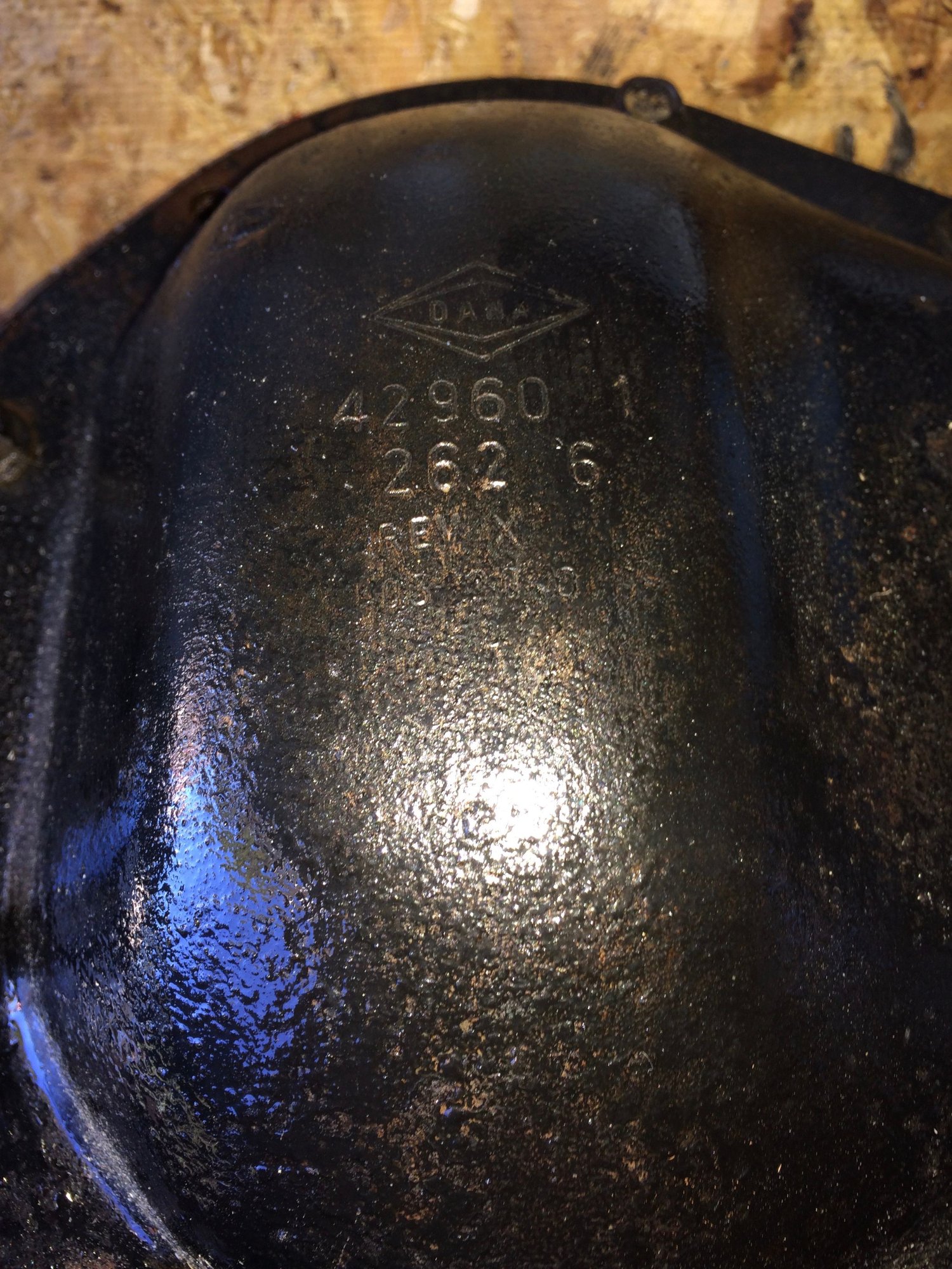

I bought this Dana 44 off Kijiji for my JK. (Mine has a D35 in it and time to upgrade for regearing+lockers) and I just want to make sure it is a JK Dana44 and the guy didn't screw me.
Numbers on Diff Cover: 42960 1
262 '6
RBV 'X

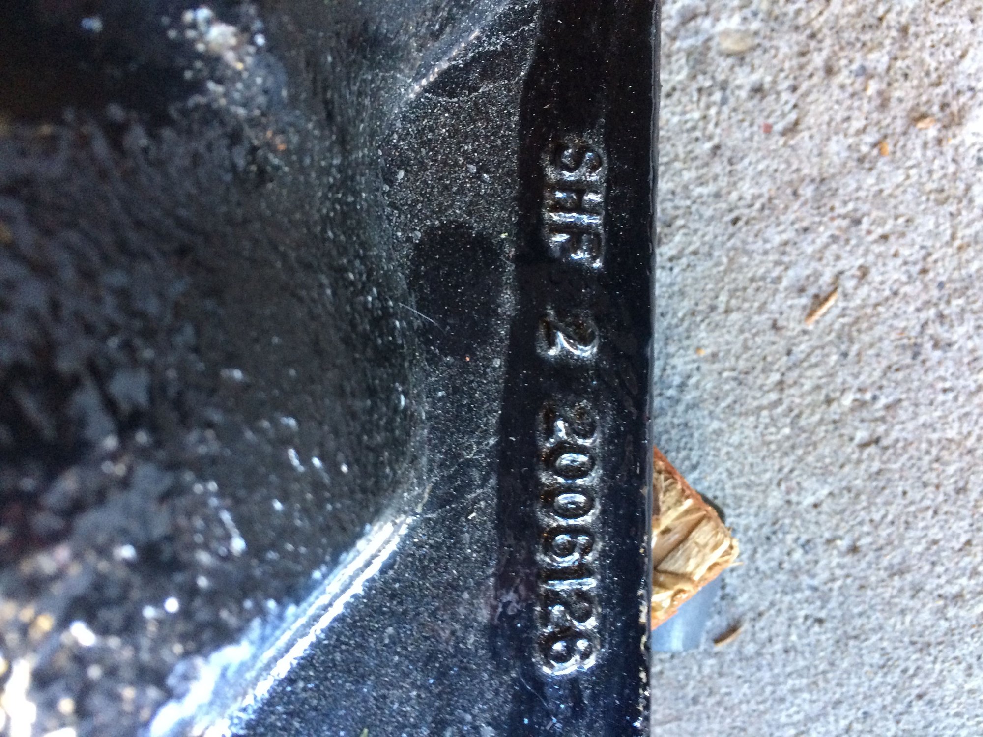

Numbers On side: SHF 2 2006126
Take a look at the pics please. Thanks a lot anyone who can help.

That's 100% a JK 44. All too familiar with those dinky factory brackets.

Great Thanks. and how could I tell if it came out of a rubi? Just need to know for buying the shafts, gears, install kits...

Open the cover, and see if there's a locker. The Rubi housings have locker wiring attached to them, so even if he pulled/ripped those out...there'd still be a hole where the wires ran through. How much did you pick it up for?

Yup, top backside of the diff you should see two plugs for wiring for rubi locker.
