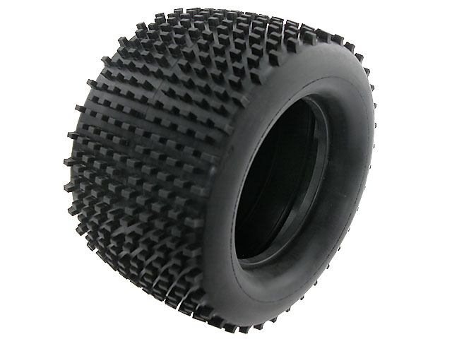

Try these on for size. wowzers.
Old Feb 26, 2010 | 02:10 PM
Joined: Jul 2009
Posts: 552
From: Montreal, QC
LOL, what's that for, an RC car ???
