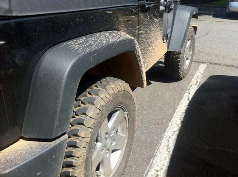

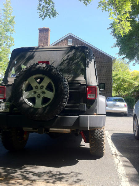

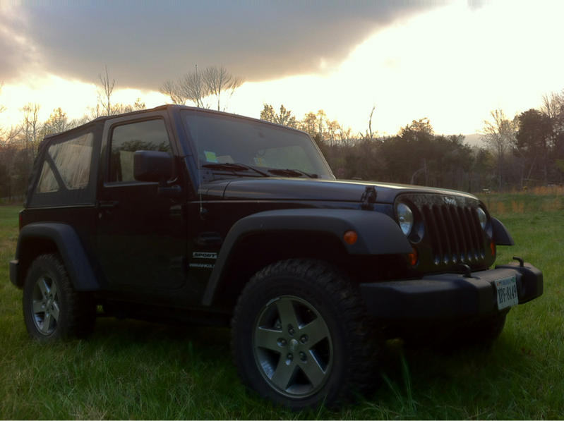

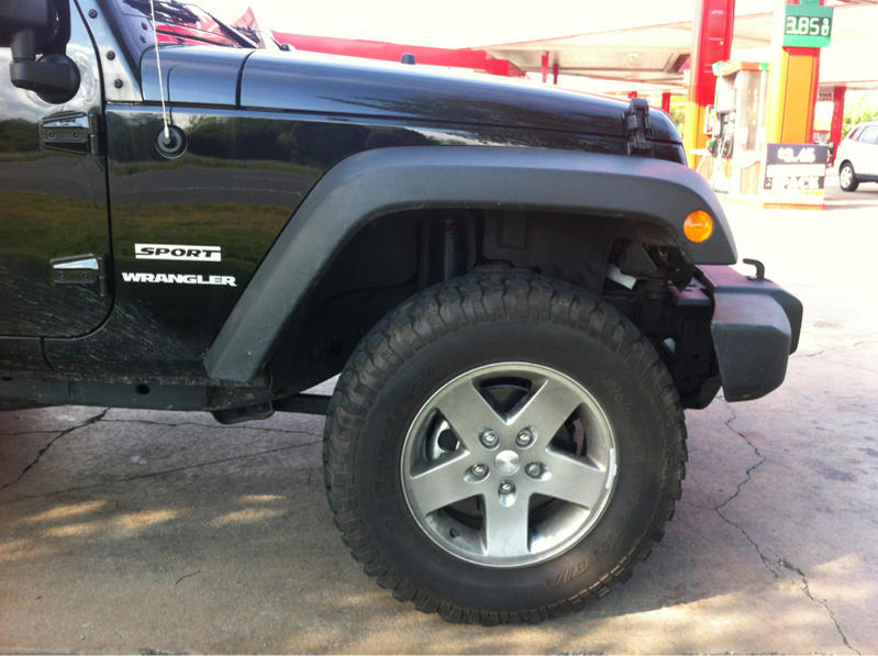

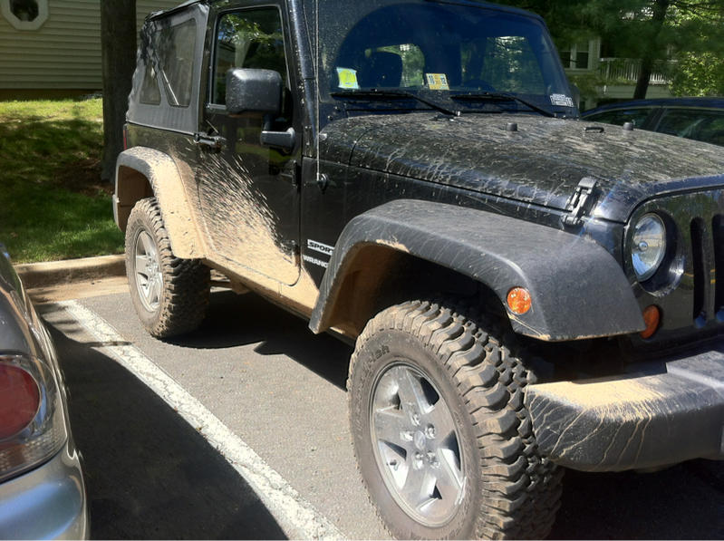

Sorry, I've been in the middle of nowhere for a few days. I wasn't expecting this much, but we measured again and got about the same results. The handling is improved for sure, definitely a good cheap improvement, and it shouldn't affect my warranty at all. Below are current pic, the last one (in the field) was before, its not good but its the only picture I have on my phone.
ID:	310581   Click image for larger version
ID:	310583   Click image for larger version
ID:	310584   Click image for larger version
ID:	310586   Click image for larger version
