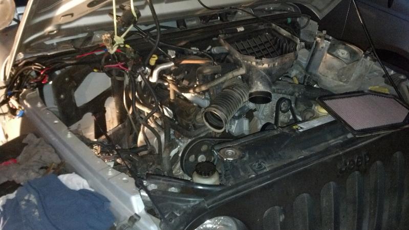

I had a battery that died I kept jumping it and after like 5 jumps it started leaking and it got all the paint on the firewall and frame came off! It was a bitch to clean sand and paint!
And yes since your battery is low it will throw a lot of different codes just because its low! I got circuit fan 1 relay, a transmission sensor and low battery but I got a new battery and now I have no codes at all!

Look what I did to be able to get all that acid off! If you have the money and the battery is old I say replace it!
