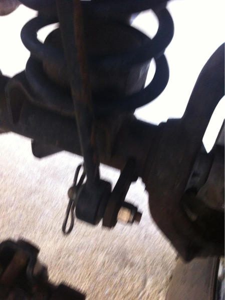

Found the problem.
ID:	461575   Click image for larger version
Old May 25, 2013 | 04:20 PM
Kolton10's Avatar
Posts: 422
From: Alabama
First pi I what it's supposed to look like and second pic is the problem
Old May 25, 2013 | 04:44 PM
Sparkplug's Avatar
Posts: 288
From: Kingsport, TN
You just need a new pin. No problem.
Old May 25, 2013 | 08:40 PM
Kolton10's Avatar
Posts: 422
From: Alabama
Got it fixed! Thanks for the help!
