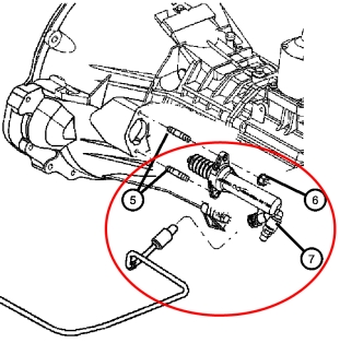

The slave cylinder has a small-almost-but-not-quite-an-O-ring that seals between the hydraulic line and the slave cylinder. That SABNQOR is very easy to lose--when I was replacing my slave cylinder I dropped it and it bounced faster than greased lighning across the garage floor. Without a sample, I figured it was just a regular old O-ring. IT IS NOT! A regular O-ring will not seal. And the SABNQOR is NOT a separately sold item--to get a new one you must buy the entire hydraulic line. If the person who worked on your Jeep was not careful, he may have dropped it and replaced it--it's very easy to do if you're not aware of it. And he may have just stuck an O-ring in from shop stock, and sent you on your (not so merry) way.
That was an great deal of explanation just to get to this: Check for a hydraulic fluid leak at the slave cylinder.
Mark,
THAT is excellent information, certainly something I am going to remember - SABNQOR (!)
It completely makes sense too. I would love pick your brain about it how it might separate from the line, exactly where it is located, what color it is, hard material or rubbery, etc? Is the hydraulic line a push-to-click fit, or does it thread in to place? I am techy about these things, and hopefully the OP will benefit too!

I had that part in my nightmares for days... I swapped out slave and master, dropped the O-Ring and is disappeared into thin air. If swapping slave or master cylinder and not line, you have to remember to pick this little piece out of the old master/slave. It's just a press in fit, but without it you'll suck in air and blow out fluid.
