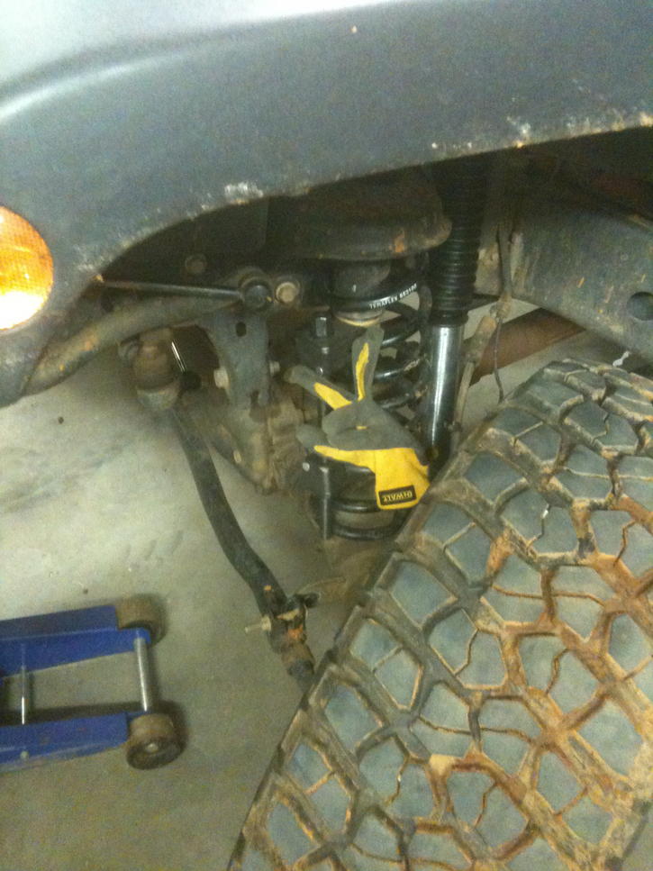

I have done it with and without coil compressors. It is defantly easier with them. We took them out with the wheels on when using them. I rented mine form our locak Oreily auto parts.
If they come with little saftey pins on them leave them on. when i was pulling on the coil to get it out the compressors slid around and slammed down on my fingers like a hughmungus mouse trap
you cant really tell from the pic because we had already taken one of the compressors off
