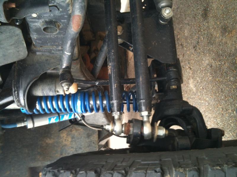

yep tons of people do it including myself. im running 12" kings with about 5 inches of lift in the rear. to be perfect i will need like a 6" teraflex spring.

Sweet, is that the rebel off road set up? Thats the one i was looking at. What kind of lift did it give you in the front? Do you think i'll need to upgrade to larger springs in the rear if I use 12" coilovers?

yeh it is. i pushed the front out 2 inches.
the rear has about 5 inches of lift and i would like to get teraflex 6 inch springs in the rear.
im probably going to get the clayton long arm because it is a full like long arm and i like the radius arm front.
the rear i will porbably go with the ORE cantilever system because it really is the best option for the rear.
in the front i think the rebel offroad kit is fine and works great. i think ORE is great but also very biased for this forum
