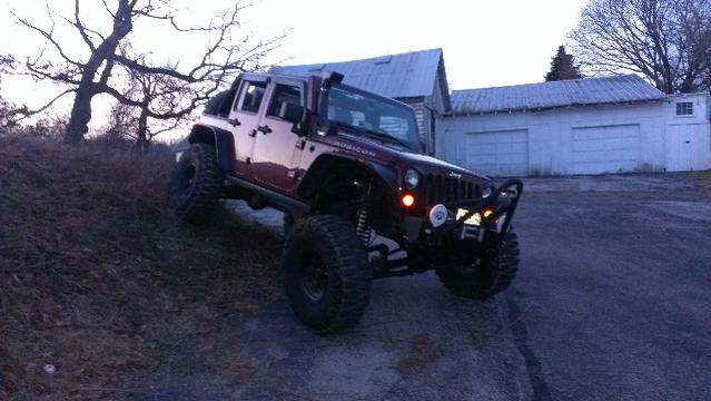

Right now I have 16 inch travel shocks in the front and 11 in the rear here is a pic but its no flexed all the way out
but I feel that the radius arms could go further

I've had several tries to fine tune my coilovers, I say for your setup you would need 250/300 front and 200/250 at the rear.
I also carry spare coils with different rates and lengths in case my jk gets heavier.
