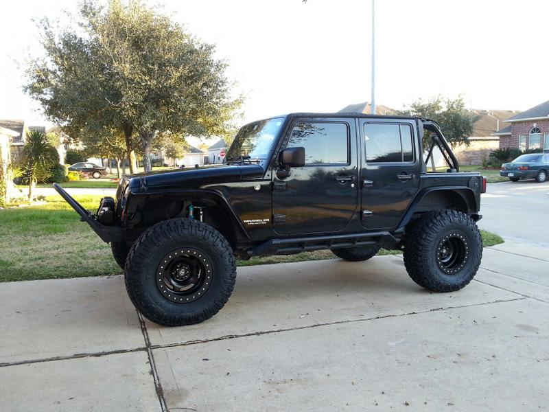

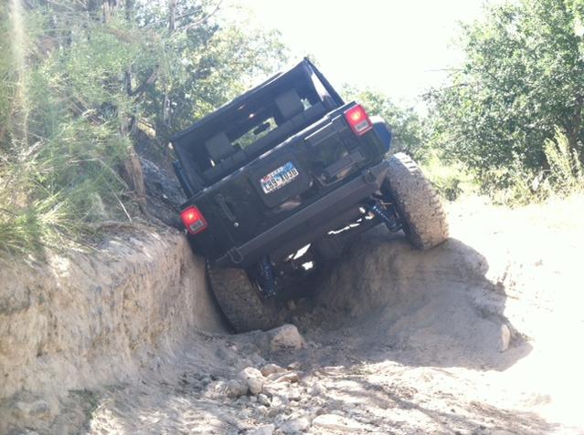

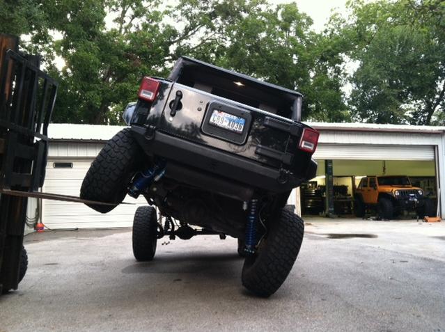

Here is my insight only for the coil overs...coil overs are the way to go if you want to fine-tune a suspension in, you could easily interchange spring rates and spring lengths yourself, they're rebuildable so it should be the last shocks you purchase. Also, coilovers could bolt in or be welded to the frame of the Jeep without too much body modifications. Coil overs allow you to stay low, I have adjusted mine to 3.5"
As far as performance, the coilovers ride very smooth, very stable in off camber situations, smoothness is consistent due to reservoir tanks, great for daily driving I can do 70+ mph on long highway curves with expansion joints and dont bounce / weave all over the road.
