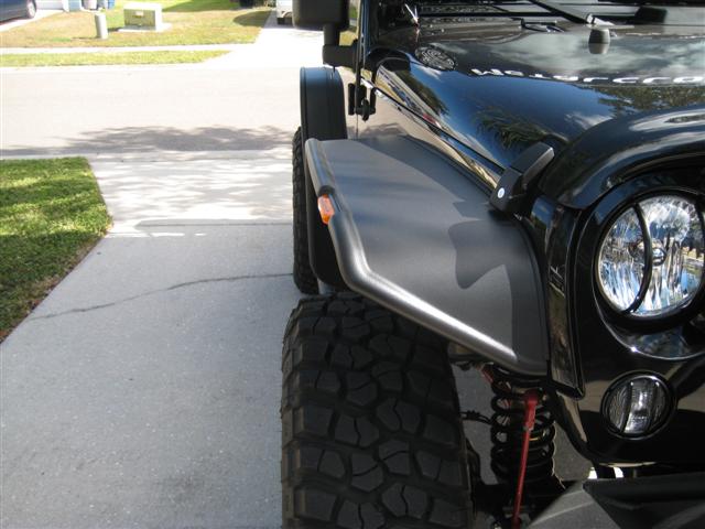

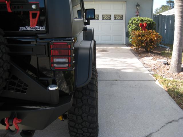

Backspacing is how far your rims are going to stick into your wheel wells measured from the mounting surface. So if you have rims with 5" backspacing and your target backspacing is 4.5" then you only need a half inch spacer to push the rims out. I am running 12.5" wide tires on 9" wide rims with 4.5" of backspacing and nothing rubs yet. I haven't wheeled them yet though but not anticipating any problems.
Oh and my wheels stick out about 2.5" past my bushwacker flatties.
Edit: You can calculate how much your rims will stick out from the mounting surface using this easy formula.
Rim width - backspacing = frontspacing.
Just remember your tires overhang your rim so you need to account for that extra width depending on the width of the tire you buy.

Here is what mine look like.Click image for larger version
Name:	Metalcloak 002 (Small).jpg
ID:	518253Click image for larger version
Name:	Metalcloak 009 (Small).jpg
ID:	518254Click image for larger version
Name:	Metalcloak 004 (Small).jpg
