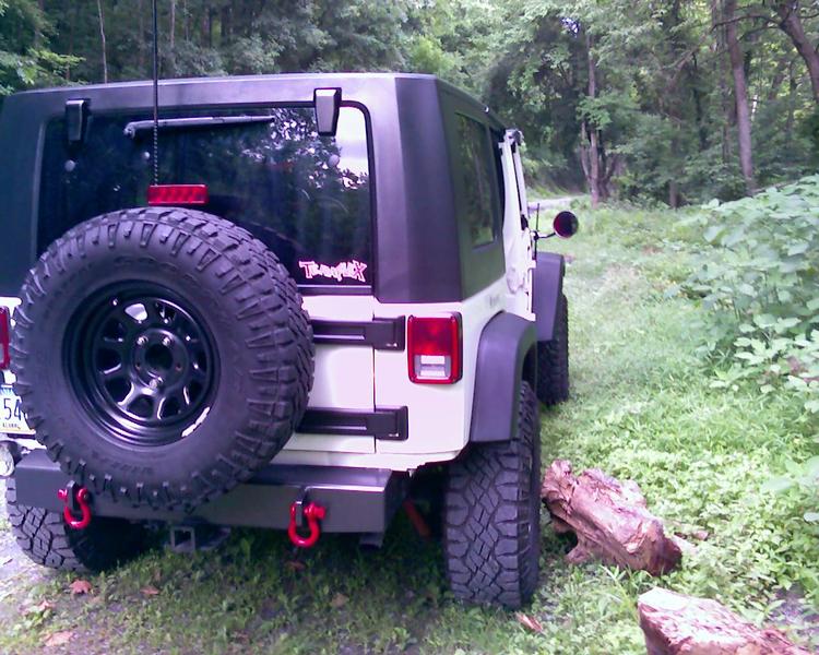

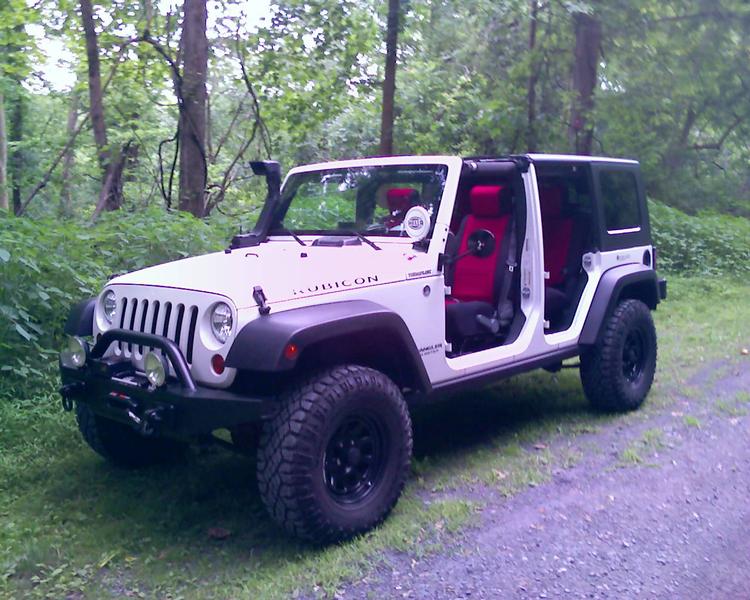

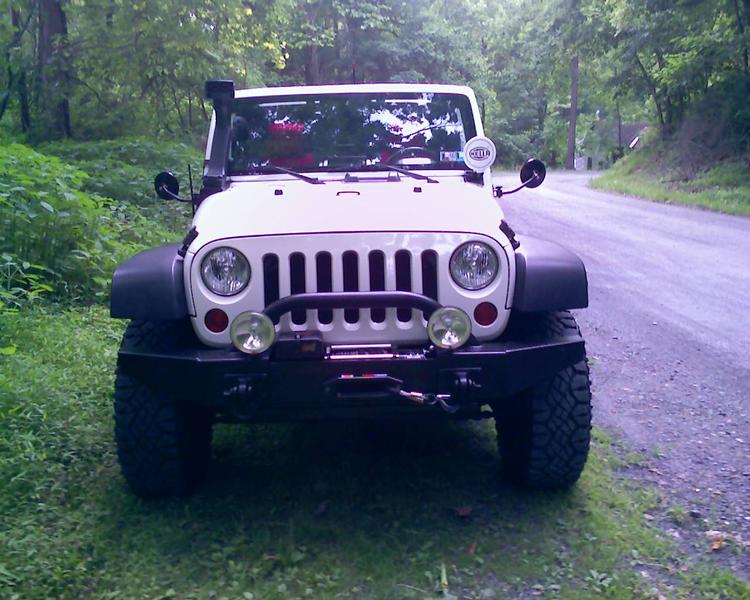

Old Dec 21, 2013 | 05:48 PM
Rubicon John's Avatar
Joined: Oct 2008
Posts: 545
From: Lehigh Valley, PA
I'm running 5" backspacing with a 16" x 8" wheel, which works perfectly for my needs. The tires and stance are wider, but the top of the tread is under the flare keeping me legal in PA.

Old Dec 22, 2013 | 12:55 PM
JK08MCS's Avatar
Joined: Dec 2008
Posts: 621
From: Redondo Beach, Ca.
Attachment 518359Attachment 518360Attachment 518357
Sort of funny. You still look like you could pick up/throw a rock or two, but they say your legal
Old Dec 22, 2013 | 01:04 PM
Cjsmith4's Avatar
Joined: Apr 2013
Posts: 589
From: Pa
I'm in Pa. My tires stick out a good 1.5" to 2" and no one has said anything to me. Just had it inspected and not a thing was said. Most times they will let ya get away with it.
