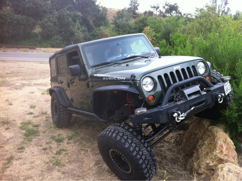

Currie lift, normal arms, 37" MTR's.

Long arms can allow you to increase down travel, But it will depend on the overall set up the the rig, as it is just one part of an entire system.
A properly set up long arm has no drawbacks to the off road performance either, in fact it will be a better then a short arm in both on road and off road at any lift height.

You are wrong, sorry. Longer shocks will increase your travel not longer arms. Arms will increase the quality of the travel but not make more travel. JKs don't have "short arms" stock. They are more like mid arms. Some people think the JK is like a TJ that has to have a long arm conversion to add more than a 2" lift that is not the case. Long arms will not help off road for anything other than high speed running, they will get in the way when on ledges by allowing the arm to hit the rocks and stop the downward travel of your axles.
