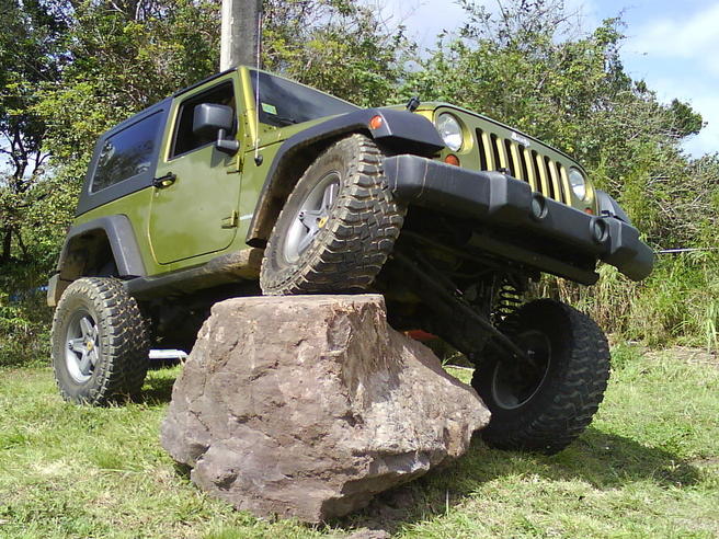

JK GABY's Avatar
Posts: 165
From: SAN JUAN P.R
Pictures can Tell more than a thousand wordsClick image for larger version
