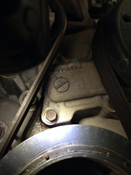

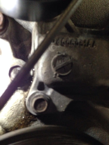

Ok so not to steal OP but I have had a slow leak that runs down the front engine behind the serpentine belt, I assume I need to remove the belt then pull the manifold??? Going to search net to see if there is a YouTube video posted. Looks like source is coming from the lower right corner.
ID:	571859   Click image for larger version

I'm sure I'm not the only one with this problem, 2008 with 53k, had an occasional drip in the garage but now it is beginning to get worse. I assume there is a gasket that is either eroding or I've got some corrosion. Looks like I need to pull serpentine belt, not sure if any pulleys need to be pulled off, just looking for some advice. Didn't want to have to go buy a manual, is there any free down loads or does any body have a file they can send me?
Is the leak from the intake manifold gasket? I can't tell from your photos but that's a common problem.
Check out:
https://www.jk-forum.com/forums/stoc...tips-276427/#b
