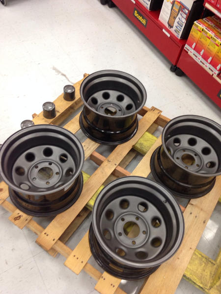

I will be removing my stock 17s and 31s tomorrow and putting on these 15x10 cragar soft 8s (4inch bs and 6inch lip) with 35x12.50r15 C km2s...
I hate black wheels, always have. I couldn't stand the thought of being just another jeeper with black wheels.

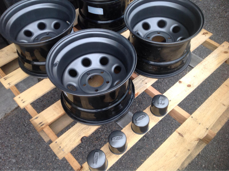

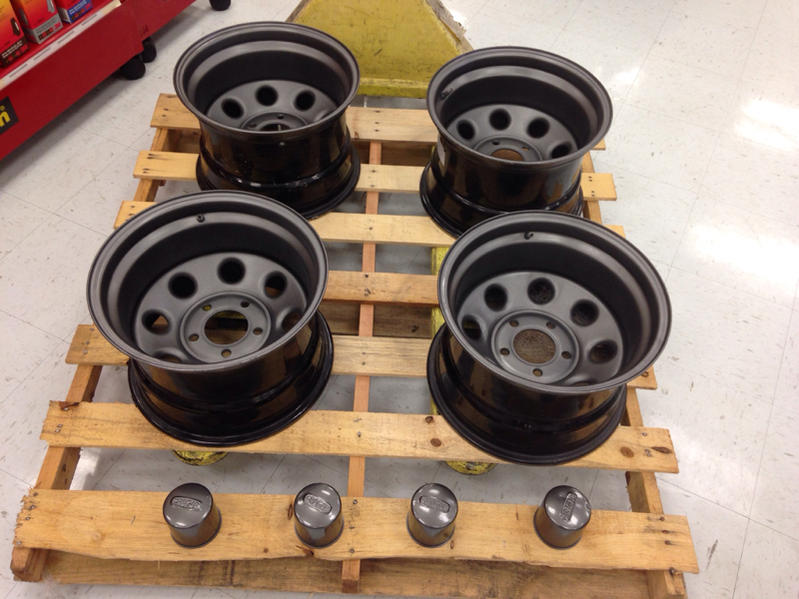

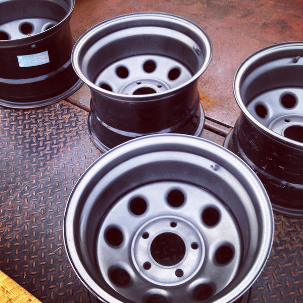

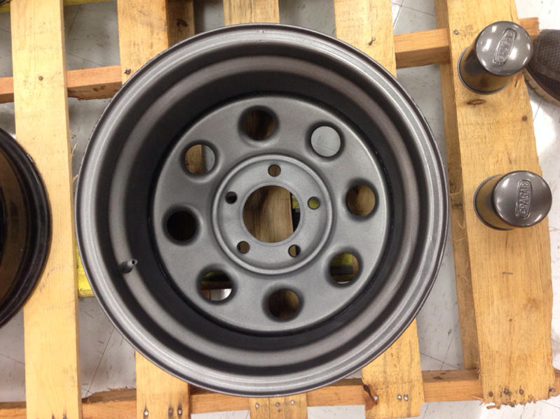

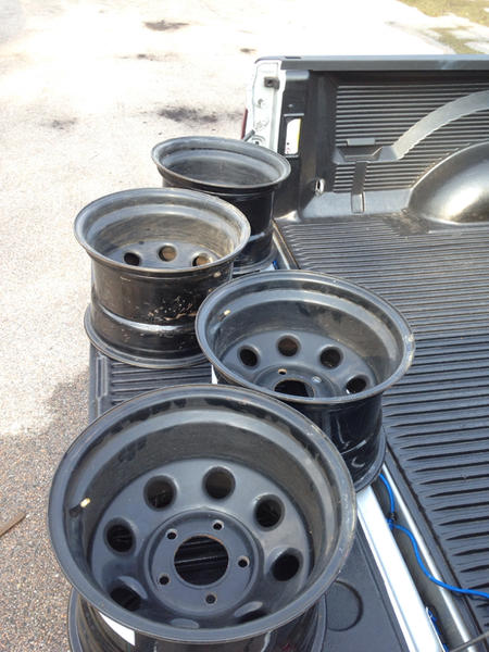

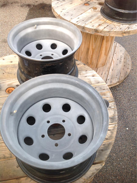

... so I went to O'Rileys and grabbed 4 cans of graphite grey metalic, 2 cans of etching primer, 1 can of degreaser and some 800 grit sand paper. I scuffed the black paint and then wiped with alcohol. I primed, set to dry and then got started on my paint. 3 light coats and one heavy coat did the trick when 10 minutes apart. I cleared them today. even though graphite is just a lighter dark color similar to black, these wheels look tremendously better. the metallic sheen is hard to see in these dooky quality pics but its a world of difference.

Pics below, I was able to use my offices warehouse pipe yard to prep and paint.

This is right after the clear coat.

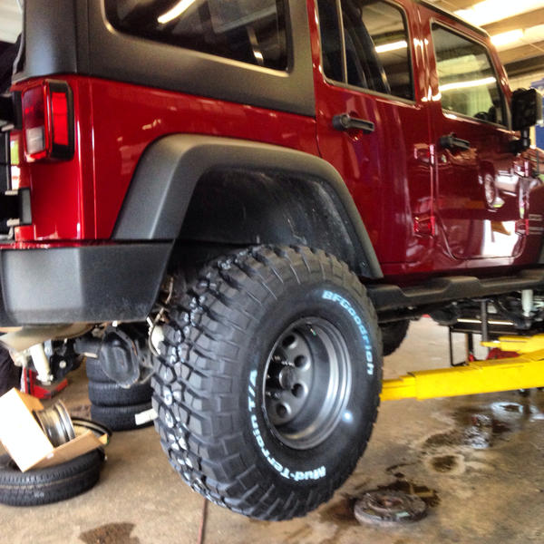

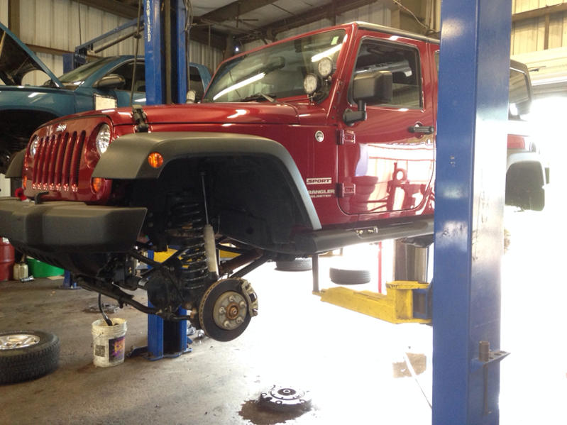

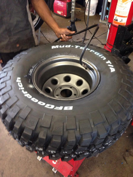

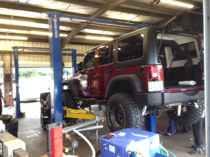

Off with the old and ON with the new.

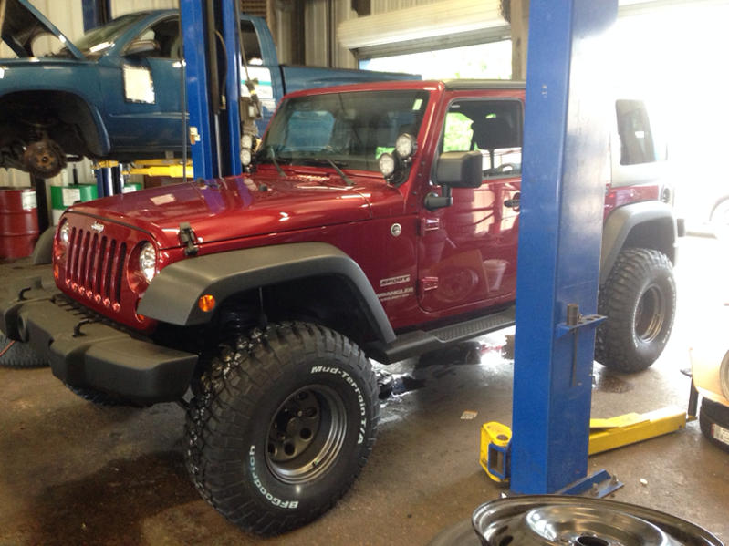

Let's goooooooo!

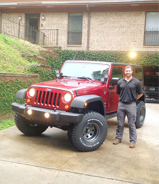

I'm 6'1" and this is with the 4inch trailmaster lift with Front LCAs and the 35x12.50r15 BFG KM2s and 15x10 graphite cragar soft 8s.
