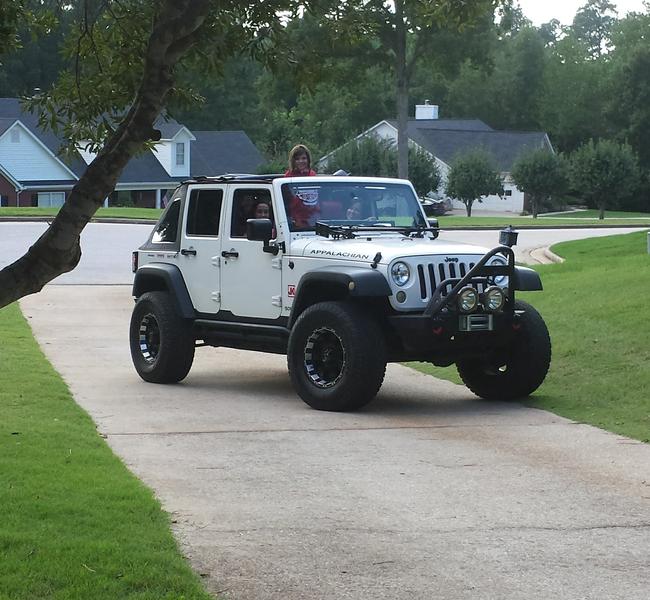

Hey all,
I'm new to the forum and jeeping. I have a 2008 4 door unlimited x with 2.5 skyjacker lift and nitto trail grapplers on 35's. On the highway, it seems to track or groove a lot. I think the tire shop put too much air in the tires for one thing. Tomorrow I am going to do the chalk test. What else would make it drive better, and be more stable? Maybe new shocks or stabilizer??? Thanks
