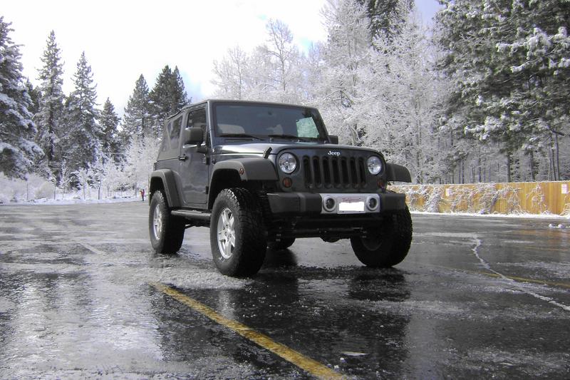

Pic back when I had cut and installed VDP end caps..

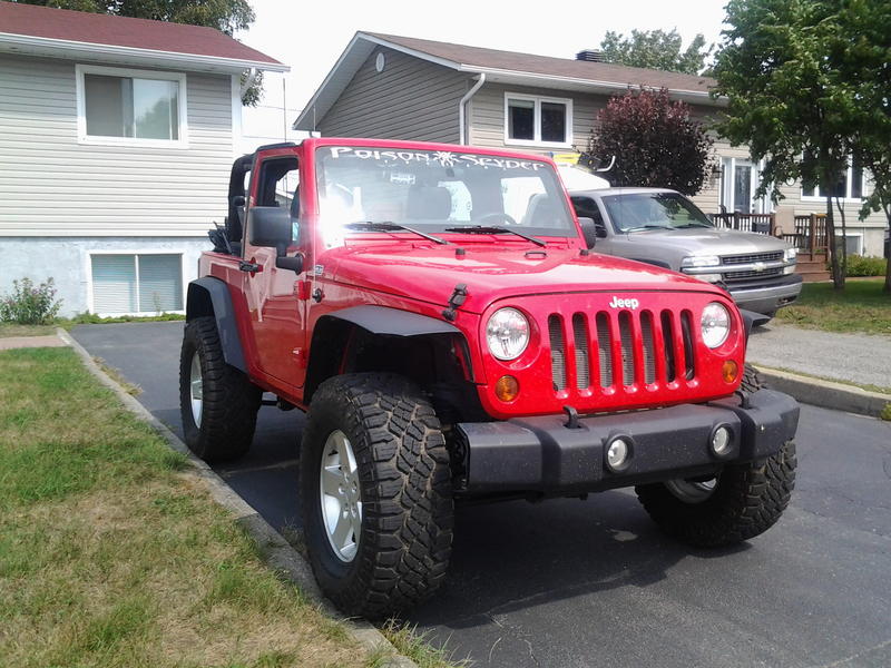

Here's mine. Overall lenght is 58". Just cutted flush to the metal inner bumper part.

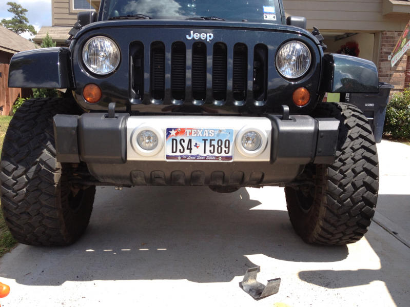

Just measured about 3-4 inches away an cut. Doesn't have to be perfect if your adding caps. It covers all the cut.
