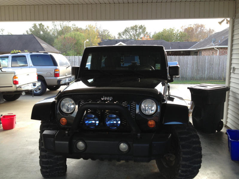

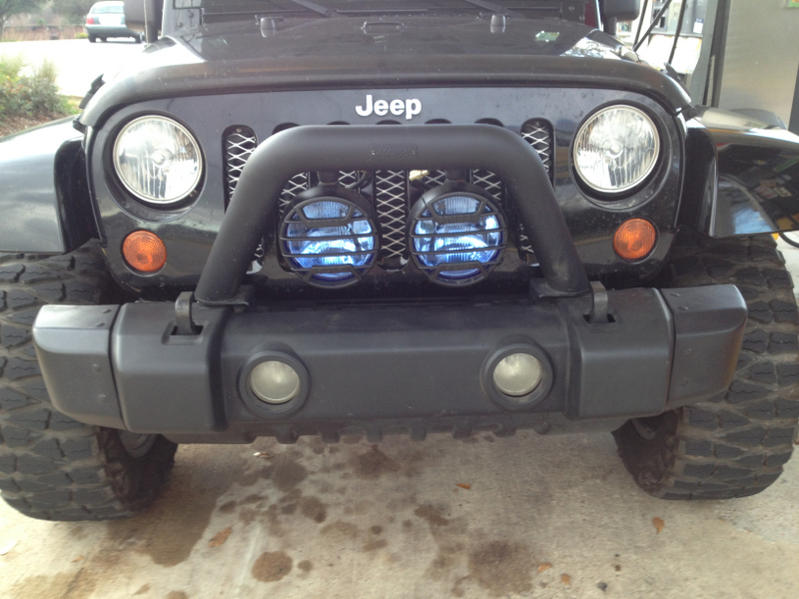

Old Dec 7, 2012 | 09:18 AM
07blacksahara's Avatar
Posts: 555
From: Thibodaux, Louisiana
Here's mine
