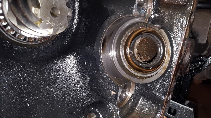

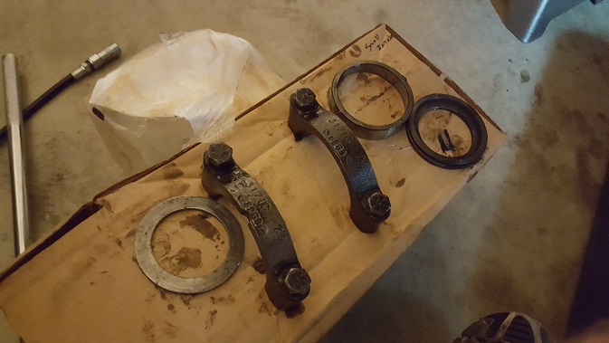

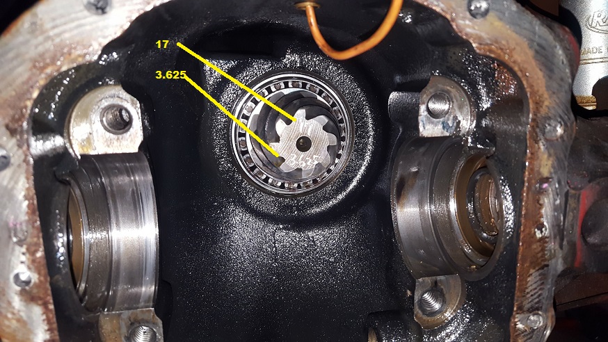

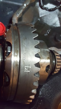

Well I got the air collar in today, and figured I'd try and have a go at it.
The carrier (assuming this is the locker/ring assembly word). Pretty easy to come out.. in fact I'm wonder if it was too easy. When I took the bearing caps off, I barely pulled on the locker and it pretty much was ready to fall out. Not sure if that's okay or normal or what.
It looks like some RTV or possible a rubber seal was chewed up as well. Kinda hard to tell by looking at the parts diagram for the D30 what they are or if I need to replace them. Any insight would be helpful!!
Also that little sliding piece of metal thing in my first post wasn't actually the air collar, it is beside the air collar. It appears to be a shim. Not sure if that's supposed to be sloppy like that?
