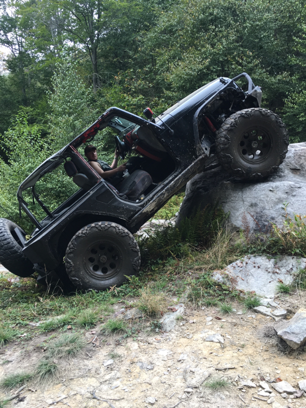

37s, 4.88s, and locked F/R.

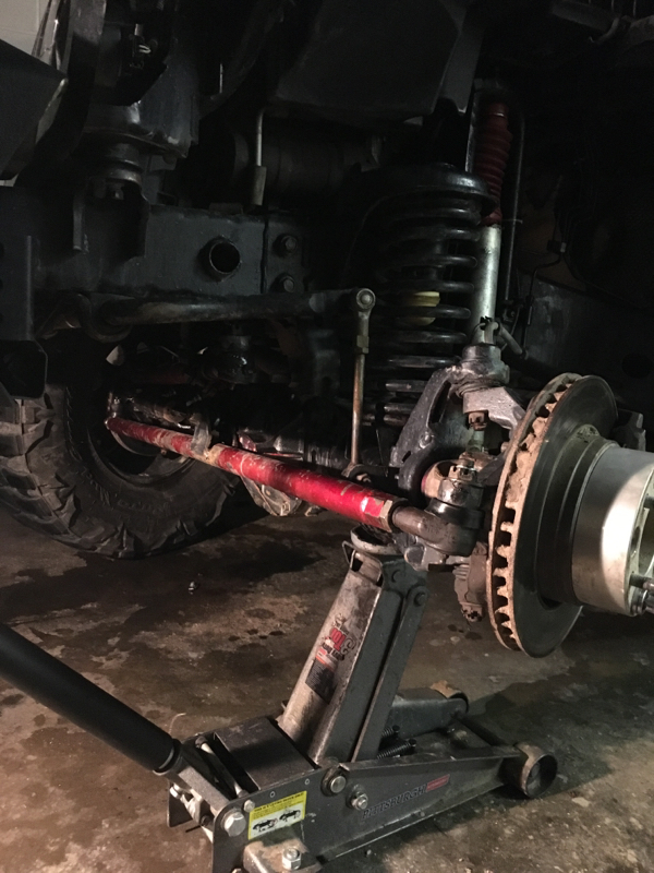

I have $276 into my hydro including a steering box rebuild from west Texas Offroad. Drilled and tapped the box, made all the tabs myself and had it all done in an afternoon/evening. Got it done around 10:30 pm and by 12 I was on the road 3 hours away to beat on the jeep all weekend and drove home Sunday. Isn't that big of a deal honestly.
