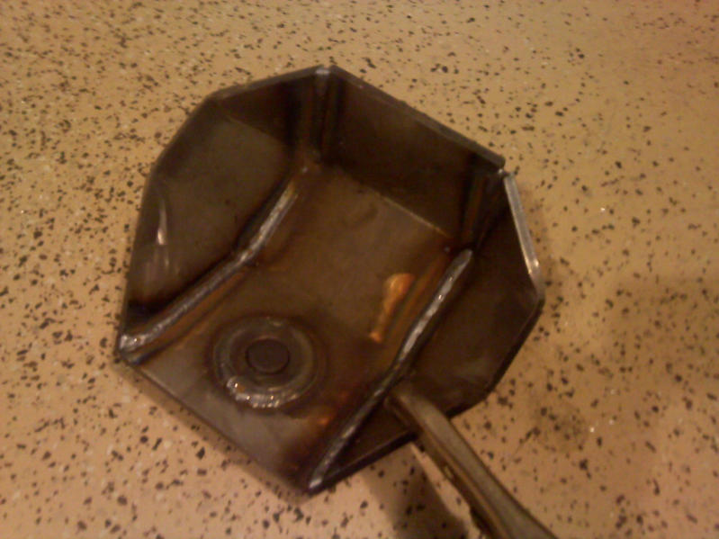

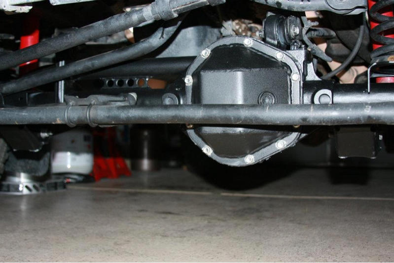

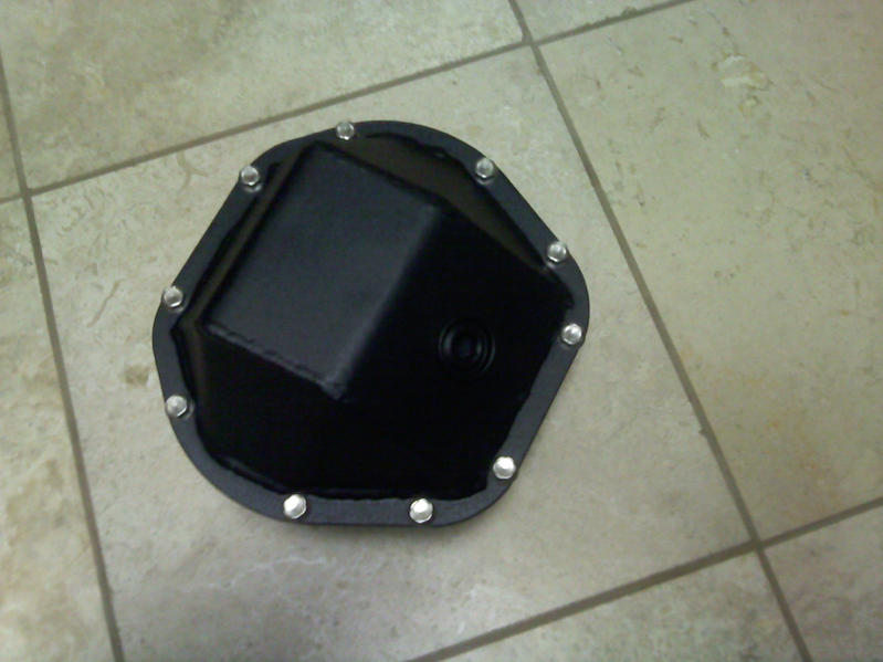

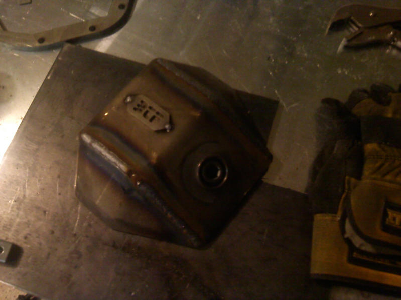

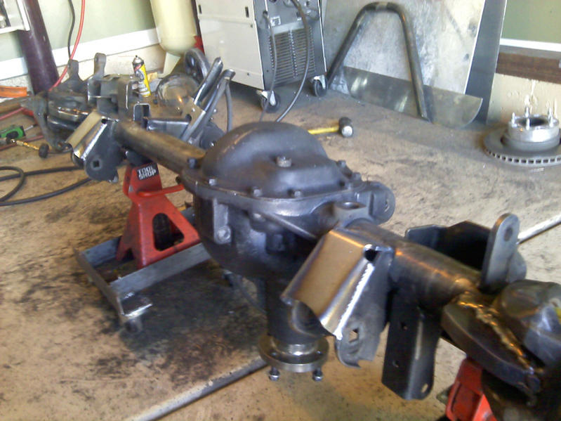

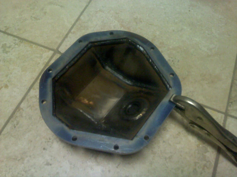

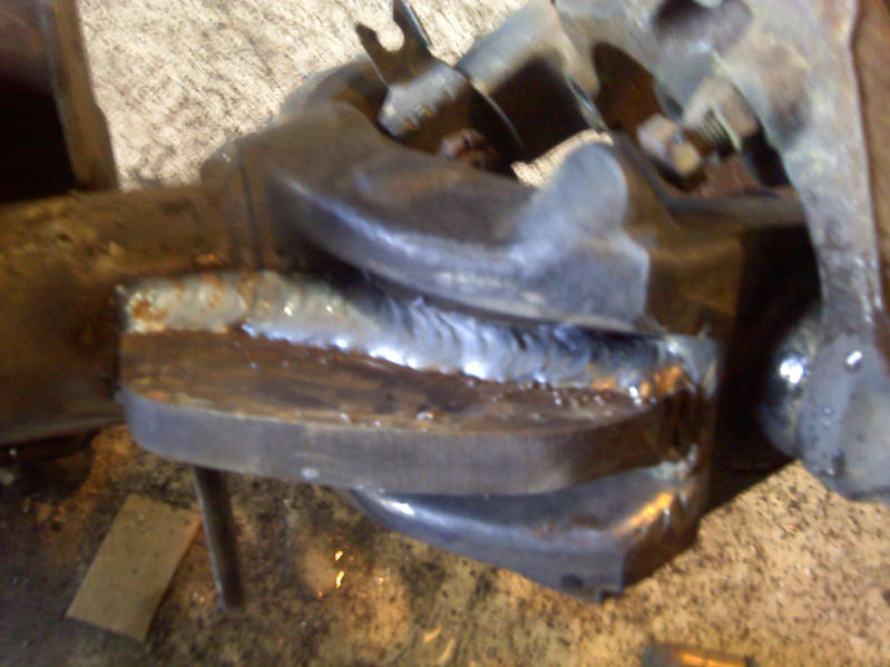

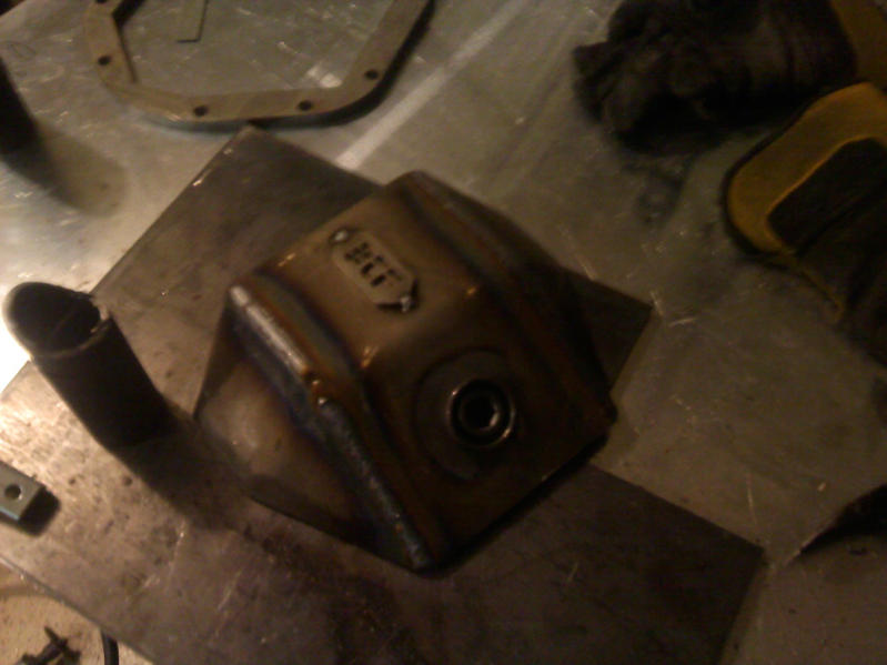

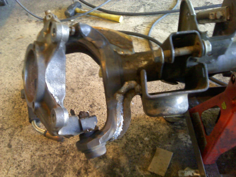

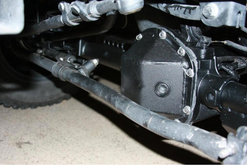

I have a rubicon but wanted to build it so I never needed to worry about the housing, I sleeved it, gussets it, put sliders on, trussed it, and welded some blue torch diff covers

Easy part is done!

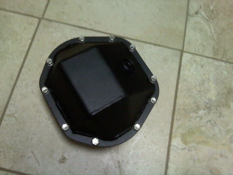

Is that a EVO diff cover kit?

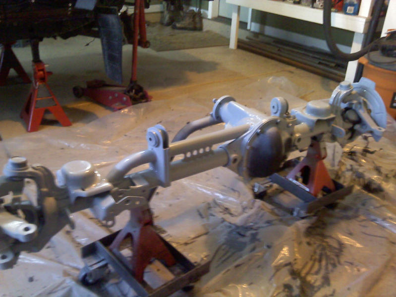

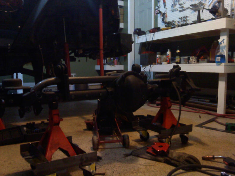

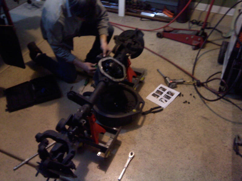

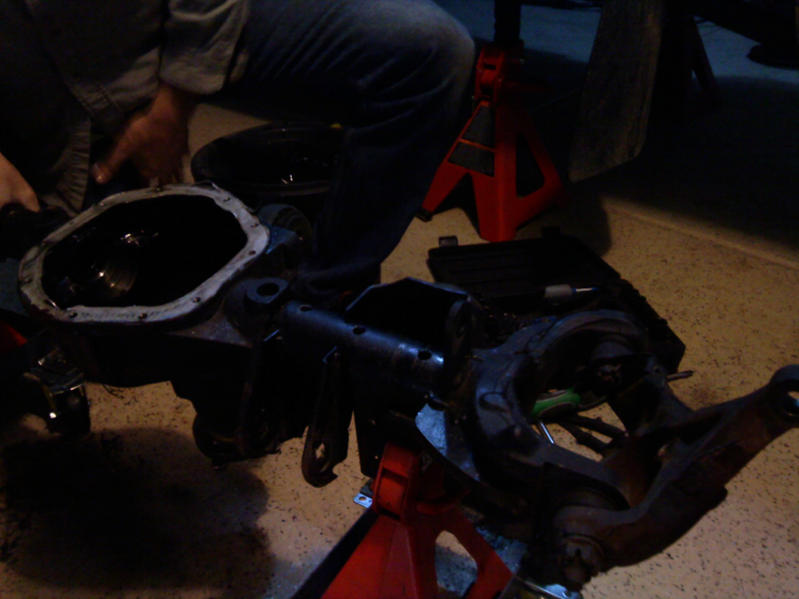

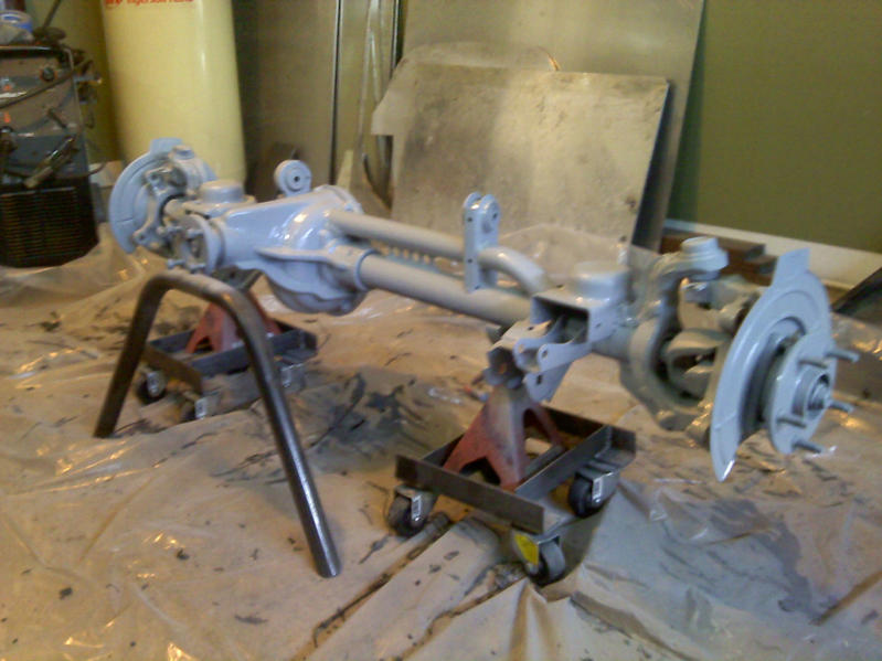

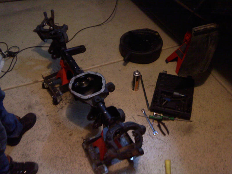

Front axle build

Blue torch, I cut their label off

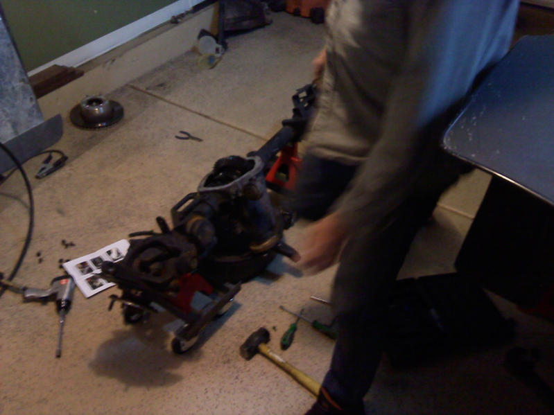

Sliders were evo, c gussets were teraflex, I live were thy use salt and wanted to be able to paint the entire c gusset surface

I use a Hobart ironman 230, I work with a lot of different welders at work and unless you make you living a Hobart is plenty good, save the money on you welder by buying a Hobart and put it towards a plasma

Don't try to weld to the cast housing, cast steel needs to be heated with a torch in order to weld to it, either your weld will break or the housing will crack, my first couple welds broke and my father in law showed me how to preheat the casting, it was a pita
