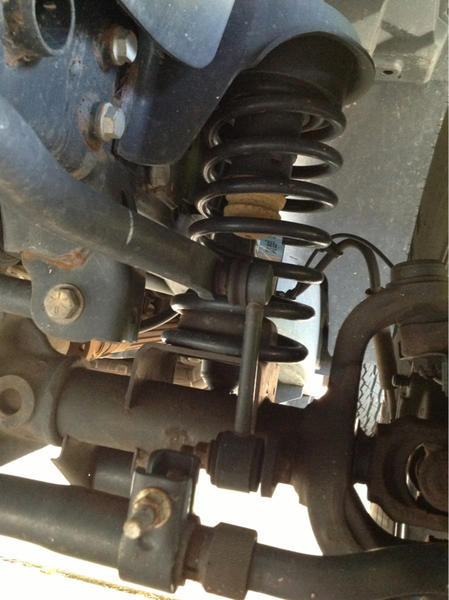

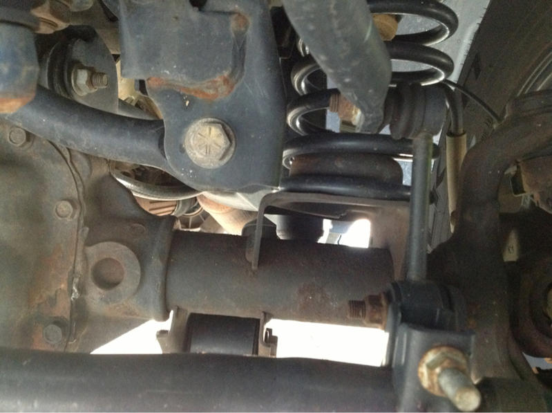

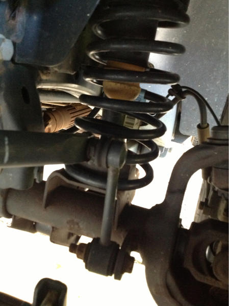

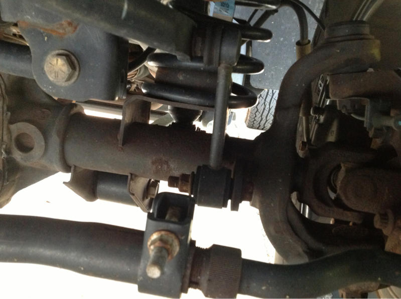

Here are a few shots of mine. Hope this helps. I ave a 2010 JKU Sahara and have had the lift for about 15 months with no problems.

Wheels are straight in these shots
