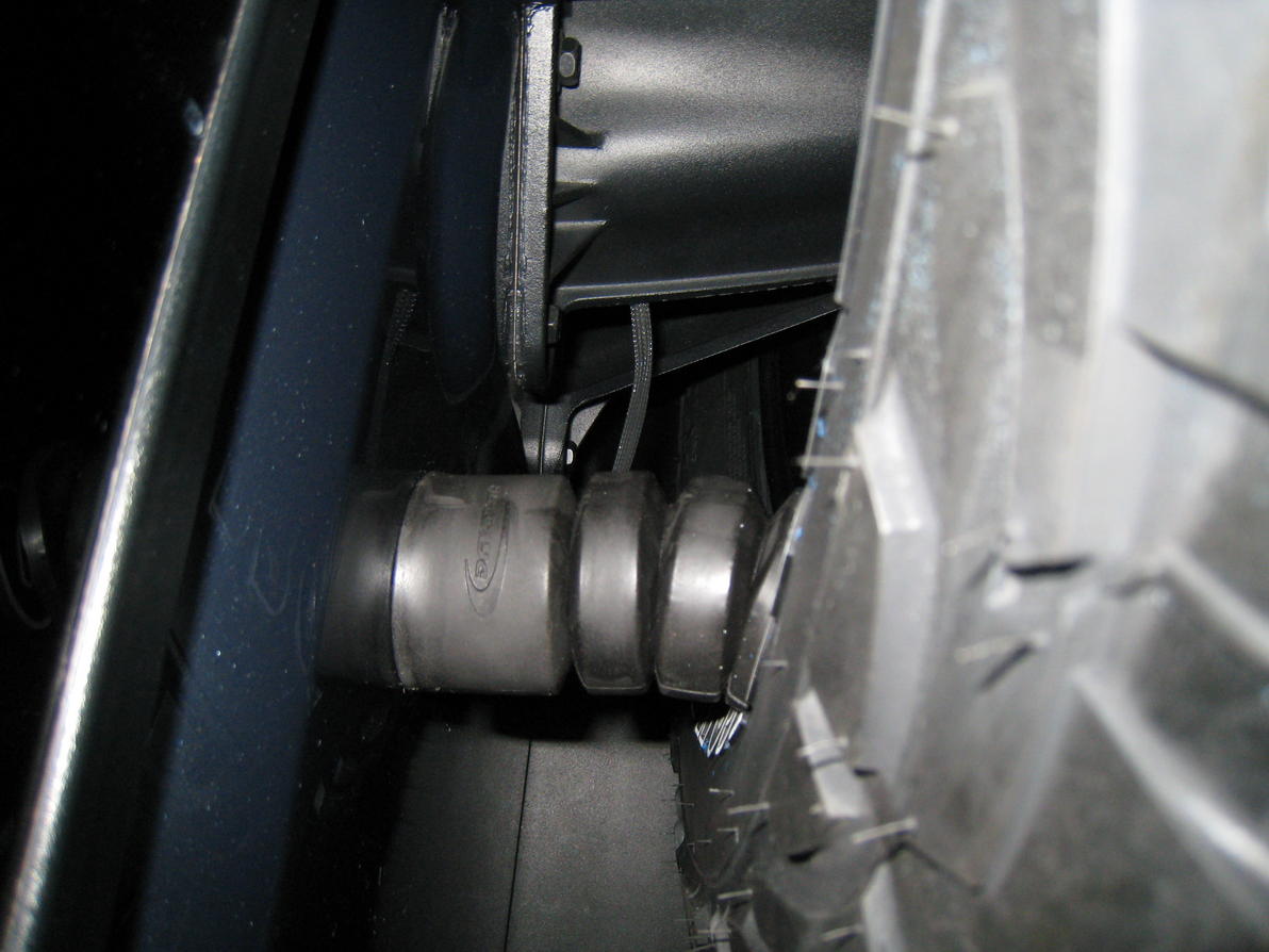

Here are mine. They work great. I used a long sharp kitchen knife to slowly cut around them. They are solid foam rubber all the way through. I only had to cut about 3/4 of the last section off. This gave it enough length to compress a bit to actually do what it supposed to do.
