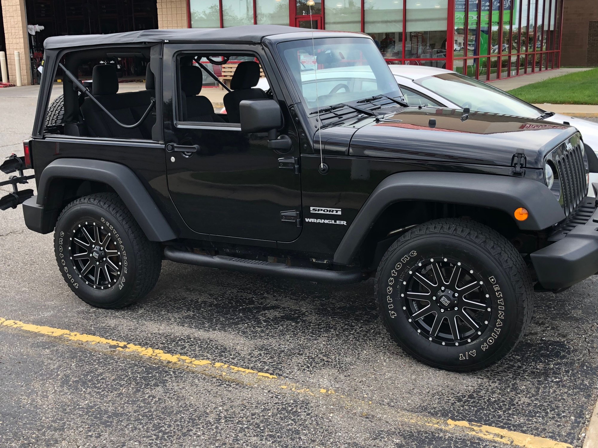

I’m shocked that this was the cause of the wobble! After reading this yesterday I pulled both front tires, removed these clips and set off on a drive. No wobble, no shimmy, nothing....I’ll be damned. Can’t believe these little clips were causing such disruption.

Those clips are not the cause of DW, and Planman even says as much in that post. Several things can assist in "triggering" a wobble, but a wobble is the results of loose bolts and bad joints. Regardless, those clips should be removed. I can see how if an aftermarket wheel/spacer is not sitting flush, it could throw off a balance, and THAT could start to trigger issues, but rest assured, if it does, it's because there is an underlying problem.

I'm with resharp on this one. Those clips will cause shimmy. They might trigger DW, but the DW will be from components involved in the steering geometry.
