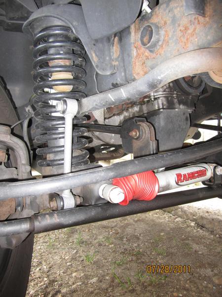

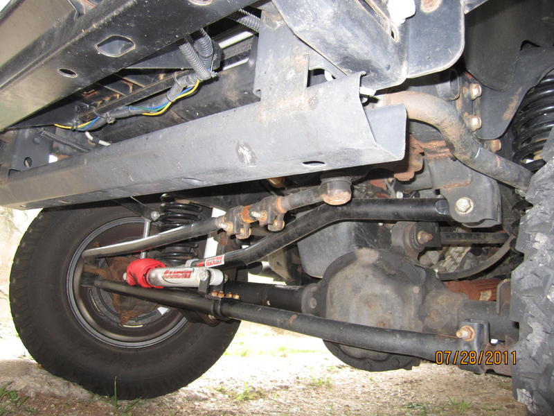

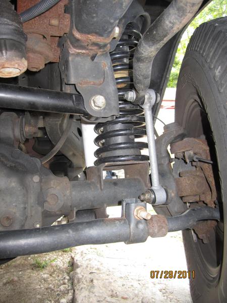

The pics BTW the balljoints have been checked along with an alignment and rotation.

Not sure if this really shows anything or not. If you need a certain angle just let me know.

The only lil thing I see is the driver side lower end of the sway bar link isn't as straight up as the other one... Might be the pic idk.. Everything else looks good. Is the track bar jam nut and bolts tight??
Still curious as to the caster setting.. Do u have adjustable control arms?

I'm just curious, is there a right way and a wrong way to mount the SS.I'm not saying that that is whats causing your issue, it's just that I have mine mounted with the body end if you will, to the axle and the telescoping end on the tie rod(the opposite of yours). Just wondering.

Hubby says thats for the high clearance SS.
