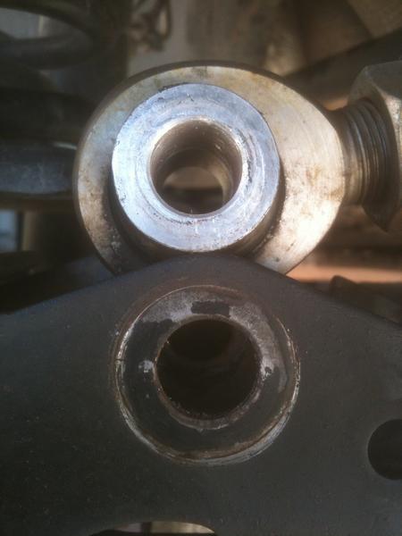

I have recently in the last week had one mild episode of death wobble and several more that I was able to keep under wraps. I want to try and catch it/fix it before it gets worse. I've read just about every thread on death wobble regarding the causes and solutions and I still can't figure out what's causing mine.
After reading up on death wobble, I went straight to my front track bar. I checked to see if it was torqued properly, and it was, 125 lbs on both ends. I unbolted the axle side to see if the bracket hole was "wallowed" out, and it doesn't appear to be. Took a pic as well, so you can see for yourself:

I checked the torque spec on all the control arms, everything is (and has been) good. Tires are balanced about the best they've ever been. I even took it to the dealership to have them check it out including checking the ball joints. They said everything is perfect. I'm just drawing a blank here. None of the classic scenarios seem to fit, but every other bump I hit now I can start to feel the wobble. If I hit one just right it goes into a death wobble and I have to slow down big time to get it to stop.
