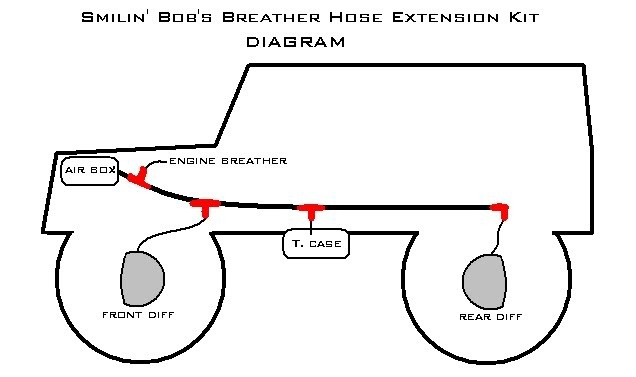

Do this...not an issue
I got this kit, but this pic is missing one. It also comes with one for the trans breather too
Sent from my obama monitoring device
Tranny breathers on autos are easy to include--there is an existing line to reroute. Us manual drivers need to find the nipple on top of the tranny. Think I'll do mine when I next pull the tranny to fix a leaky rear main seal (forgot to do it when I swapped the clutch).
