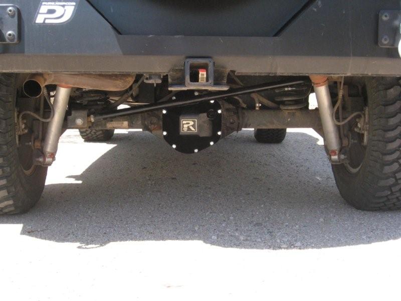

Riddler all the way, baby!

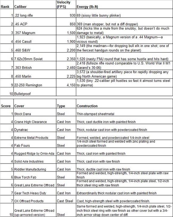

Originally Posted by RedneckJeep
I wouldn't buy a cast cover even for a boat anchor.
...and the reason is...???
The nodular iron cast iron covers are ductile, i.e. soft and malleable. It will take a hit.
Are you thinking of old-fashioned cast iron? That went out about the same time the internet came in.
No. I'm thinking of high strength steel such as 1/4". Most all of the high strength steel covers faired much better in the JP Magazine cover shootout than the cast models. Cast metal tends to break or crack rather than stretch. See for yourself. Nothing old fashioned about it.
http://www.jpmagazine.com/techarticles/drivetrain/154_0708_bulletproof_test/index.html
I see your point. No, wait, I don't. I haven't been shot at (much) on the trail lately.
For lack of someone offering a better way of realistically performing a diff test, I'll go with the results of this one for now. Here's the results summarized.
Where exactly does it state the superiority of high-strength steel? The last one that's 1 inch thick? Cast Iron and Cast Steel hang tough. The Great Lakes Extreme Offroad came in behind both Cast Iron and Cast Steel. It isn't until it is beefed up to extraordinary lengths does it win.
