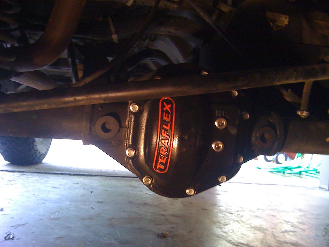

Peeled my stock diff covers and they were leaking, got Teraflex covers and all is well.
