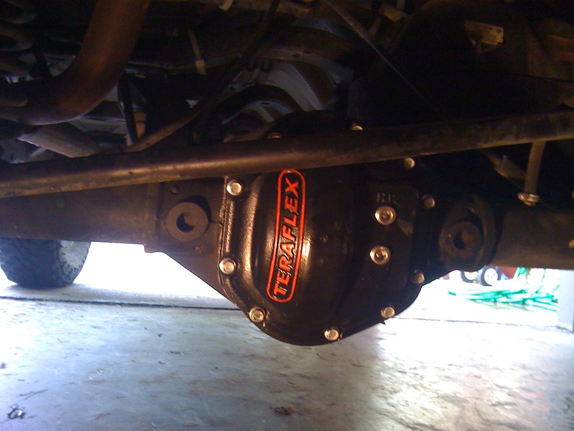

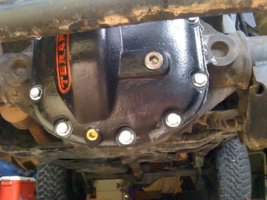

Not to hijack this thread- but seeing the pic of the TF has gotten me curious. Which diff covers allow you to simply add diff fluid until level with the fill hole (like you can on the stock cover)? I've heard that on the Riddler covers you have to measure the fluid (in pints?), if not the excess is blown out the blow tube and makes a hell of a mess!

The front, I filled till it ran out the hole.

The rear, filled to first hole, closed, then added another 1/2 qt at the top hole cause of my pinion angle, still wasn't running out the top hole though. All is well, no gear oil upchuck.

Thanks for the info MKJeep!
