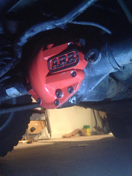

2011 Rubicon. Stock wheels & tires. No red, no problem. .75 spacer. Rancho in the front ARB in the back.
