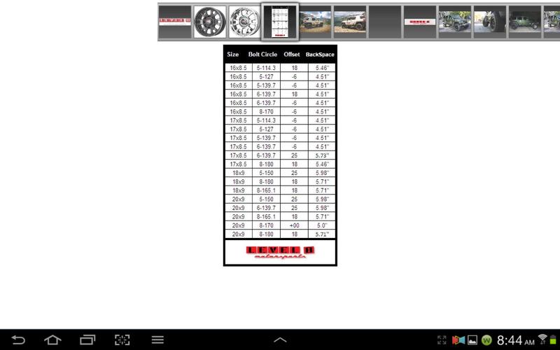

Just picked up some "level8, guardians" two options. Both 16x8.5 5-127, one -6 offset one 18 offset. Both 4.51 backspacing. How can they have the same width and backspacing and different offsets?

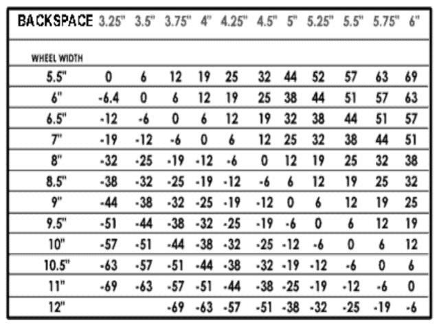

If the wheels are the same width with different offset they cannot have the same BS. I would measure the BS with a 2x4 and tape measure.

Here is a chart with the offset/backspace.

If I did this right. here's the chart I got.
