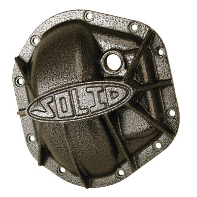

Solid has pretty competitive pricing for their covers
I was looking at Solid as well. They look pretty beefy. I was just concerned with how beefy they look, if I might have to start worrying about any TB interference problems.

Originally Posted by Rednroll
I was looking at Solid as well. They look pretty beefy. I was just concerned with how beefy they look, if I might have to start worrying about any TB interference problems. It's hard to judge by looking at pictures, if there is a concern or not.
I had Solid front and back ... Only in the back now because I have a PR44 set up in the front now. Good cover doesn't and didn't interfere with anything ... Only thing is I had to make a dip stick to properly measure fluid levels.... No biggie but I wish they had an overflow hole when you reached the proper level
