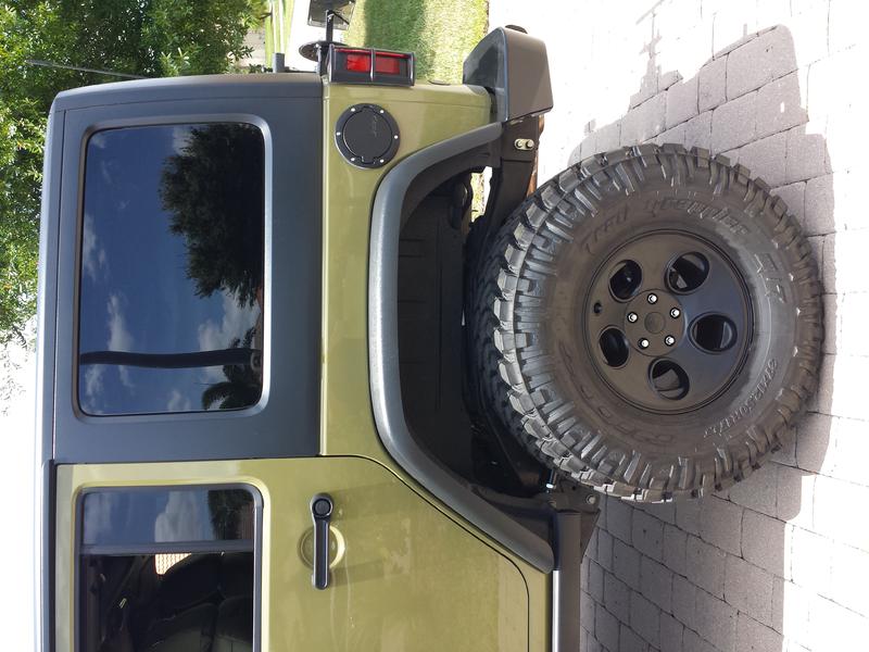

I am with a lot of these guys. I won't run spacers and 37s due to personal experience although a lot of people do with no issues. I have a 2013 rubicon unlimited and ran method nv wheels and they were great wheels but held mud like crazy. I switched back to savegre like on my 2007 and love them. I am running 37 Nitto trail grapplers with rock krawler 3.5 max travel kit. I added two stainless 3/8 lock washers on my steering stops and lost very minimal steering and absolutely no rubbing. When I tell you I tested it I did full lock and compression of spring. Like I said many have their own opinions as I do but from the responses this may help you more since you already have the wheels. Mine is also a daily driver.
This was the only one my phone but I will post some more off my ipad when I get to the house

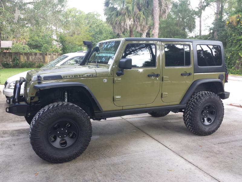

Sorry I was referring to the one post after mine. I haven't changed anything still just using 2- 3/8 lockwashers on steering stops. Sorry I haven't posted that pic I will pm you them on the jeep my little guy has been sick and im posting from my phone while waiting in Dr. office

Default Here ya go
